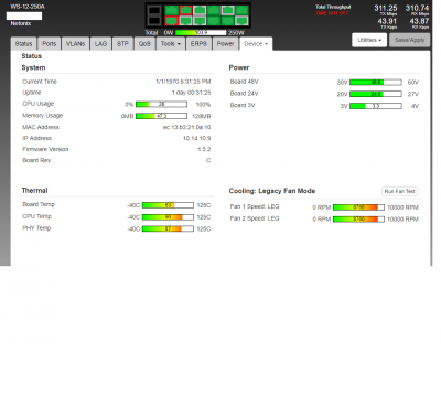

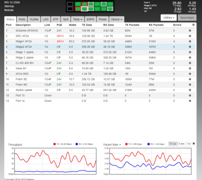

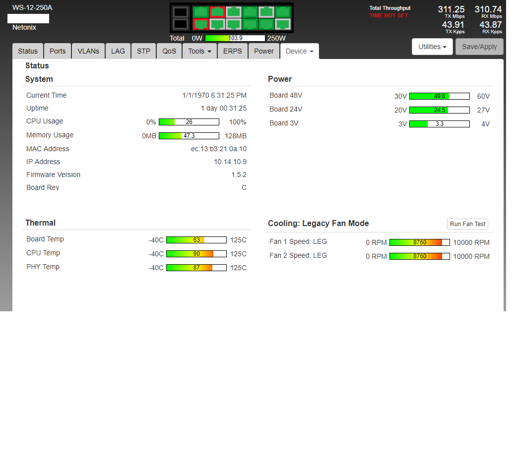

Does this also exist in the 12 port models?
I have a WS-12-250A, and ports 1-4 were all powering 48V devices.
Port 1 AF5xHD 48VH
Port 2 AF24 48VH
Port 3 AF24 48VH
Port 4 AF24 48VH
It's been working fine for a few months, but it seems since its warmer (80s with sun on the cabinet) 2 days ago, all 48V ports stopped working.
We sent a tech out, power cycled the switch, everything came up, so we left.
1 hour later it happened again, the tech went there, power cycled it, opened the door for a couple hours, and everything was fine. He closed the cabinet door that evening.
The next day, ports 3 and 4 AF24s went offline. I was able to login to the switch remotely, I changed the port 1 AF5xHD from 48vh, to 24v, and port bounced ports 3 and 4. They came back for a moment, but again went offline, no LAN, showing some wattage draw but not the normal amount.
On a hunch, I powered down port 4, hoping to at least get port 3 AF24 to operate (it feeds a busier micropop), and that worked. So I sent a tech out and he put the AF24 that was in port 4, into a POE brick for the time. That was yesterday and so far, everything is ok.
So,
Is it too hot?
Is it the same issue as the 8 ports?
48V getting over worked?
WS-12-250A
Firmware Version 1.5.2
Board Rev C
Port 1 AF5xHD 48VH
Port 2 AF24 48VH
Port 3 AF24 48VH
Port 4 AF24 48VH
So,
Is it too hot?
WS-12-250A
Board Rev C
