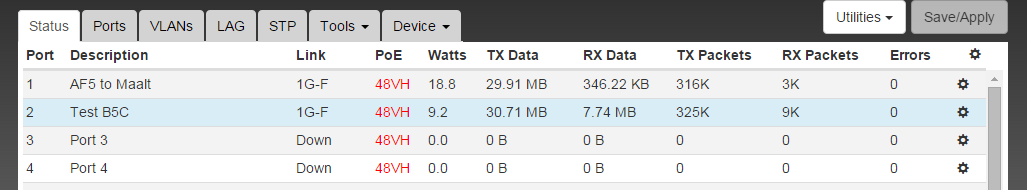

Re: Mimosa Radios and WISP Switches
So looking at that screenshot I see two things jumping out at me,
1)an apparent Airfiber running under 20 watts
and
2) the B5C running under 10 watts
How is this miracle possible ?!?
and

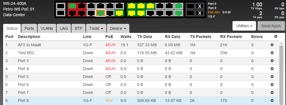

For those interested, here is my non production B5C running on a no VH port. While booting I saw a max of 12.9 watts. but then it settled down to around 9.8 watts.
This radio isn't connected to another radio, it's just sitting in the data center. The wispswitch is feeding it with 50.2 volts
rockhead wrote:So looking at that screenshot I see two things jumping out at me,
and
Depends if the AF5 is connected to another radio or just sitting there throwing out beacons. The current sensors are pretty accurate. My AF24 units pull on average 47-49 watts depending on cable length.
