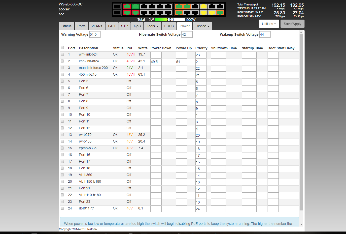

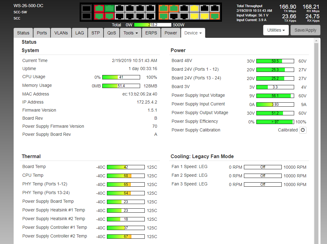

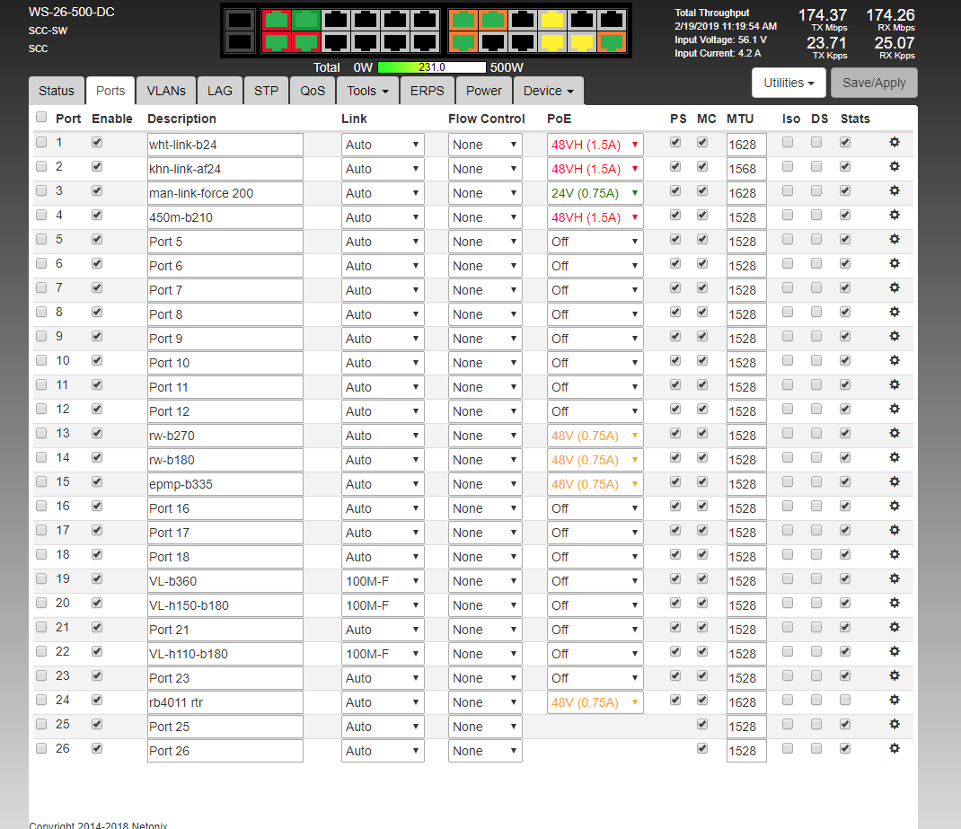

We purchased 2 - WS-26-500-DC switches about 3 weeks ago. deployed 1 of them 2 weeks ago and are getting random reboots. running version 1.5.1. Both of them are labeled with mfg date: 3/3/18. I just opened the spare and it does NOT have the zip ties shown in this thread. Switch is connected to a 48v battery bank. battery bank is being charged with a minnkota MK460PC 4 bank charger.
within the 1st 36 hours of deployment, it had rebooted 4-5 times, then didn't for about 10 days and then started rebooting 1-2 times / day this weekend. I have been watching it this morning and haven't seen the error on the status page under cpu temp yet.
I added a screenshot of the status page.
Any ideas?

Re: WS-26-500-DC REBOOT ISSUE EXPLAINED
OK so you are saying the following (Please confirm):
The switch is connected directly to battery bank hopefully with an inline fuse or better yet a breaker.
Your then have the charger connected the battery bank separately.
Of course the unit has the cabling correct as that issue was nearly a year ago with the ties and we changed all of them at that time that we could. All in our warehouse and even pulled back inventory from Distributors and changed them. But in the end it was more the power supply firmware than the cabling as there are many units out there with the cable tied still operating normally with the firmware upgrade. That unit was MFG on 3/2018 which is indicated in the box label so WAY after the cable issue.
As far as "occasionally" seeing an ERROR on the power supply telemetry shown on the Device/Status page is OK, it happens "occasionally", it simply means the data was corrupted or lost on that update cycle which happens every second. If it happens frequently that could be a problem.
Please explain your electrical service and grounding:
Is it an older existing electrical service you tapped off of and if so explain who the service belongs too.
How far is the service ground rods from the tower ground rods?
Are the ground rods from your electrical service BONDED to the tower ground rods and if so please explain how they are bonded.
Also could you please post up screen grabs of your Status, Ports, and Power TABs.
