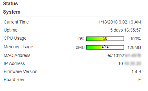

Can you post a screenshot of the Status page and Log from one of the switches?

I've since rebooted the 6 that were having issues and they are no longer showing the 366 days of uptime via SNMP. Its got to be a bug in how it gets the information or the initialization.
