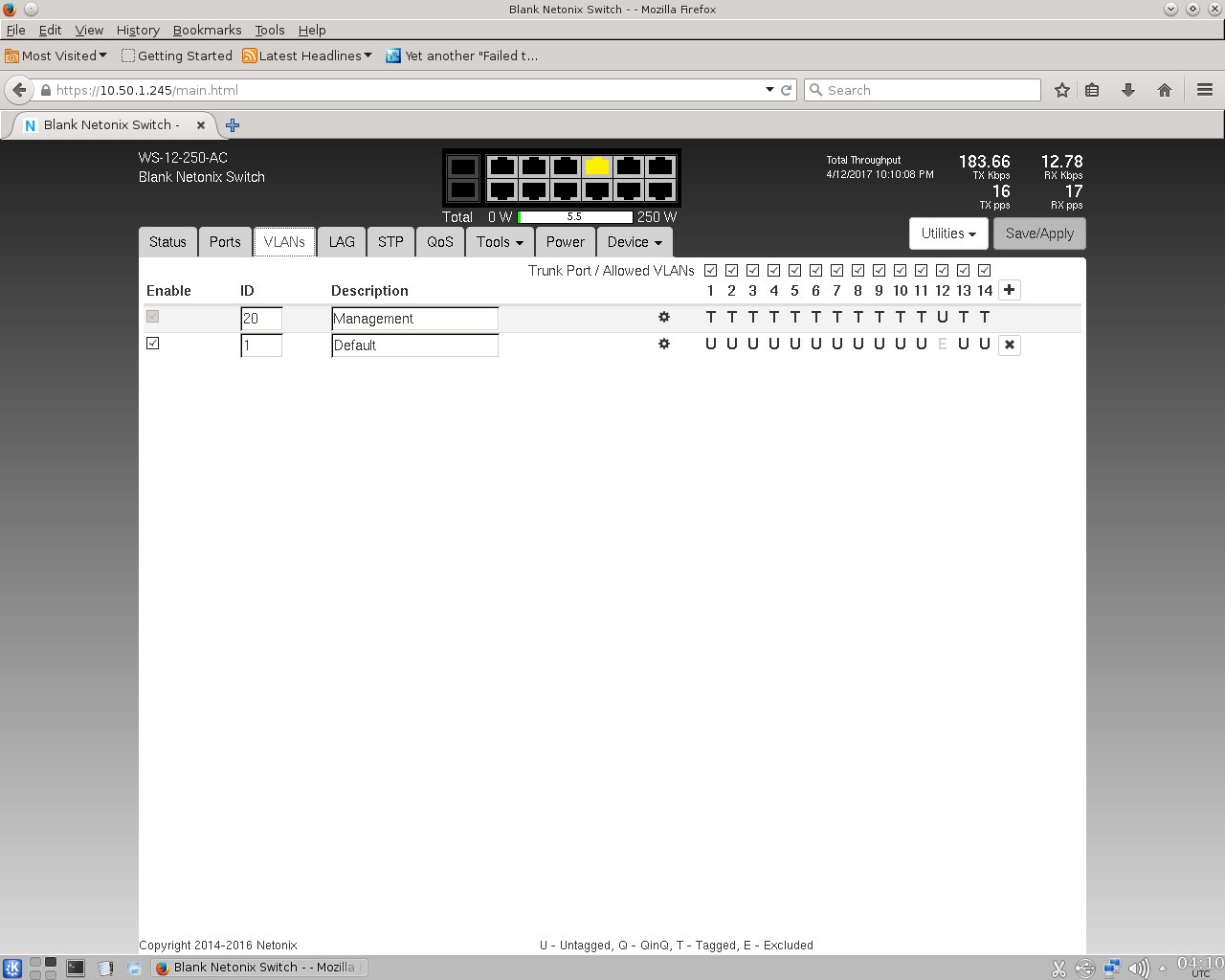

Hi there Sirhc.
I just need one question answered if possible. I have HP-2510G switches in my backbone. In those HP's they have a separate entry for the Maint. VLan with a number (in my case 20) for the VLan and an IP for the switch. I Program those switches with ID 20 tagged on all ports to flow the Maint. VLan through the system. I leave one port untagged (Typically #24) untagged for a on-site technician to plug a laptop in with the proper VLan IP. From there he can access any piece of equipment on the Maint. VLan in the system. In this switch, I have set the first VLan ID to 20 and added the next VLan to ID 1 (default) and untagged all ports except port 12 set to exclude. I untagged port 12 on ID 20. I do need the Default VLan for normal switch operation with other Non-VLan networks.
I am replacing a few of the HP's with the Netonix DC models at some Solar Sites.
This seems to be doing mostly what I want. The only issue that I have is a question over, is that on the HP switches, you cannot send an untagged packet into any port on the maint. VLan network except the one that is untagged (Port 24) and access the switch. In this switch, I can. Any port, even thought it is tagged for ID 20, will access the switch without a tag. On all our Ubiquiti radios in the backbone have a separate box to check for a maintenance VLan and an ID, just like the HP switches. Have I missed something, or am I stuck with the "any port issue"? It will work, but I was hoping it would get VLan ID 1 away from the internal address of the switch.
Thanks in advance for any suggestions.
John

Re: VLAN's
Please post a screen grab of your VLAN TAB.
- JohnJaeger
- Posts: 3
- Joined: Tue Apr 04, 2017 6:29 pm
Re: VLAN's
In your config above the switch UI/CLI/SNMP/SMTP or any other communication to and from the switch "itself" (not packets simply traversing it via other VLAN definitions) would be with a packet with the VLAN ID TAG of 20 except port 12 which is for local Tech to plug in and access the switch without a VLAN ID set on his laptop interface.
VLAN ID 1 is all U's except Port 12 which is excluded so your Tech plugging in on Port 12 could NOT see any of the other equipment at the site.
With this configuration ports 1-11 and 13-14 would only accept Untagged packets or packets with the VLAN ID of 20 all others would be dropped
Any Tagged packets with ID VLAN ID 20 received on ports 1-11 and 13-14 could only exit another port with VLAN ID 20 except port 12 which it would leave as an untagged packet
Any Un-Tagged packets (the VLAN ID 1 is not really used as all U on all ports for this VLAN definition) received on ports 1-11 and 13-14 could only exit another port (1-11 and 13-14) as an Un-Tagged packet and are excluded from leaving port 12

sirhc wrote:In your config above the switch UI/CLI/SNMP/SMTP or any other communication to and from the switch "itself" (not packets simply traversing it via other VLAN definitions) would be with a packet with the VLAN ID TAG of 20 except port 12 which is for local Tech to plug in and access the switch without a VLAN ID set on his laptop interface.
Hi Sirhc.
Thank you. That first paragraph is what I needed to know.

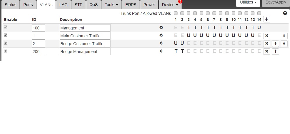

I need help setting up a separate vlan on ports 1 and 2 to allow for a bridge for a customer. The equipment for this bridge is on vlan 200. Our normal backhaul and distribution radio management is on vlan 100 which works well. This bridge does not need to communicate out the main backhaul which will be on port 3.
I need the techs to be able to plug into the Netonix on port 14 and manage both the normal equipment on vlan 100 and the bridge equipment on vlan 200 yet keep ports 1-2 and 3-13 apart.
I added the vlans for ports 1 and 2 yet when I am plugged into the 14th port I am unable to communicate with the radios on vlan 200 in ports 1 and 2. If I set port 14 to U for vlan 200 then I can talk to the radios but I lose communication with the switch.
Any help would be appreciated,
Thanks,
Tom

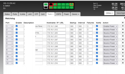

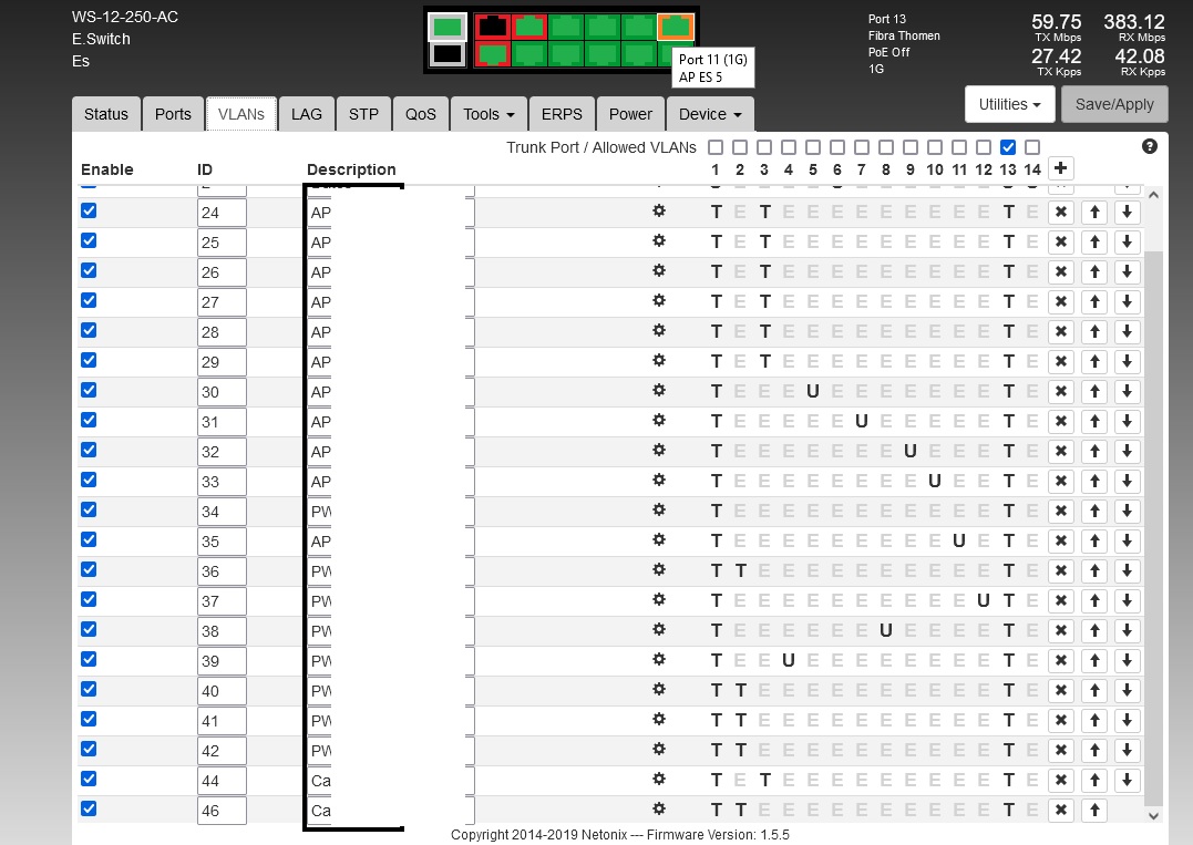

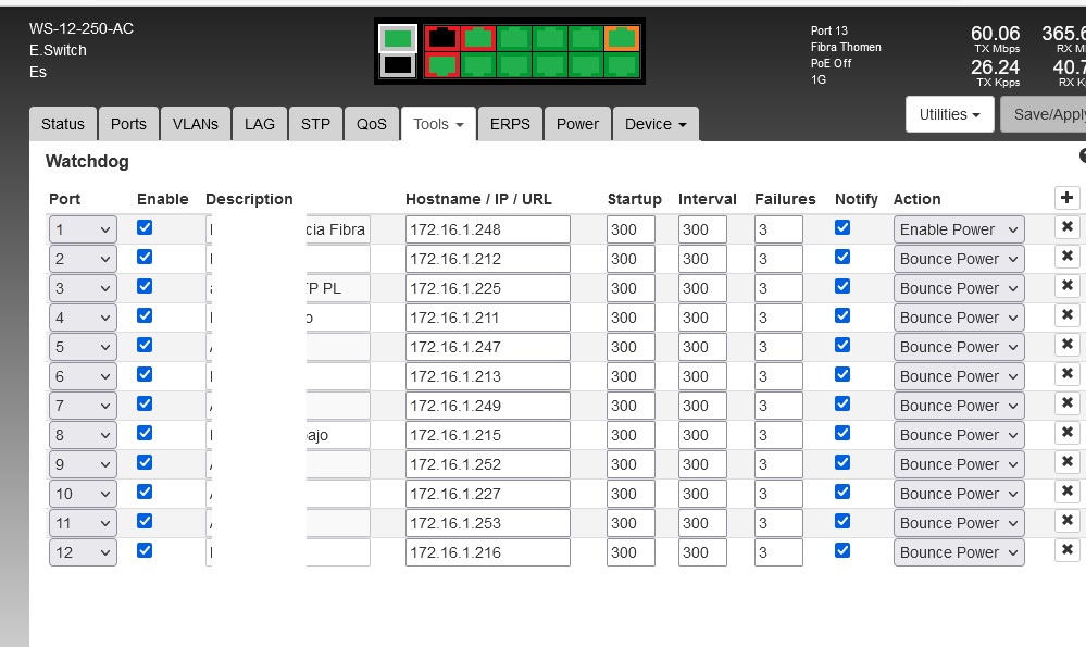

Re: VLAN's
I have some problems with the VLANs of Port 1 and Port 13
Currently port 1 is configured as Backus, if the Ping is sent to the server, the POE of port 1 is activated, of course, if port 13 does not have communication
The scenario is the following Mikrotik VLAN ----- EdgeSwitch --- Netonix
The problem that happens is that you lose connection and you must remove the trunk port in the netonix and activate it again and everything returns to normal
Any idea what may be happening here
