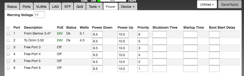

No figure in either power down or power up. Just Warning Voltage which was 10.5v then I raised it to 11v Still too low to send out meaningful time for us to change batteries. If you look above, we had a low voltage warning (11v) and then 10 minutes later it shut down

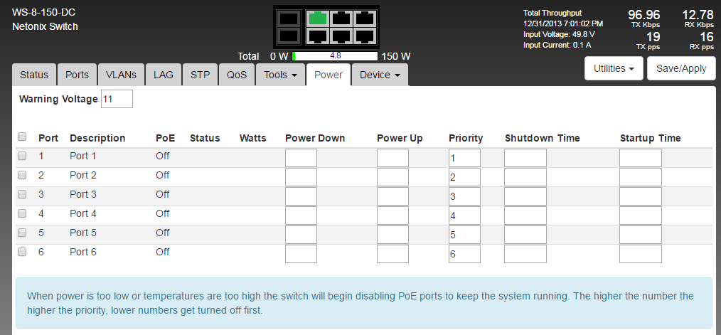

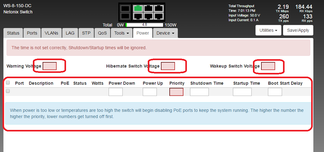

OK we have an issue where if you upgrade to v1.4.7r5 or newer for the WS-8-150-DC it messes up the Power TAB.
Below is the power Tab for the WS-8-150-DC in v1.4.7rc4 and older firmware which is correct.
Below is a picture of a WS-8-150-DC Power TAB that is simply WRONG with v1.4.7rc5-rc7
I am posting up v1.4.7rc8 shortly to fix this.

Thanks -I've upgraded to v1.4.7rc8. Its not altered my power tab much (as posted before) BUT put in 'default' figures for Power Down /Power up

I have a WS-8-150-DC and run it at 24v directly from batteries which are solar charged. I'd like to know what the Hibernate and Wake-Up voltages are set to? I'm not able to configure or even see these values in the Power Tab like I can with my WS-12-250-DC units.
I have my Warning Voltage set to 22.5 volts, but I have no idea when it cuts out and when it comes back on.
