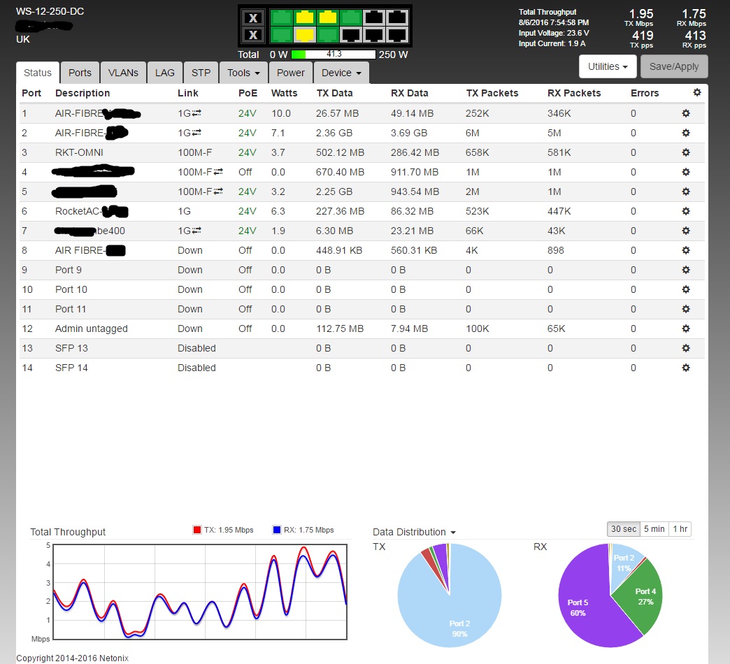

2.1amps is the current load. it will be 2.4 amps once I add another radio. using the calculator Dave provided when on mains it will be around 24vdc input (due to 27 ish volt battery float). When on batteries around 21v input.
Re: 2nd attempt to use Netonix
wisp-wand wrote:2.1amps is the current load. it will be 2.4 amps once I add another radio. using the calculator Dave provided when on mains it will be around 24vdc input (due to 27 ish volt battery float). When on batteries around 21v input.

I will check that further, we are using Mikrotik as PPPOE and I can packet sniff, perhaps check each VLAN and see if I can work out where it might be coming from, tricky to do though as I guess I need STP enabled to see the leaky traffic, but when I do that the ports shutodwn!
The switch is still up and seems fine although CPU is 40-60% when I am logged in, is this normal?

When you first log in the CPU is higher but if you sit there and wait it may drop.
My 24 port switches hovers around 30%+/- smaller switches usually are lower CPU.
Disable these things one at a time and see what process may be eating CPU:
1) Discovery Protocols
2) Discovery Tab
3) SMTP service
Warning: There is a fix in v1.4.3rc4 where if your SMTP server is mis-configured, the SMTP server is slow, or the SMTP server can not be reached that can mess up the switch as the SMTP alerts did not used to be a background process.
Note: CPU utilization has "nothing" to do with switch capcity as the CPU just runs the UI/CLI, stats, and Daemons such as controlling STP. All packet switching is done in the core.
