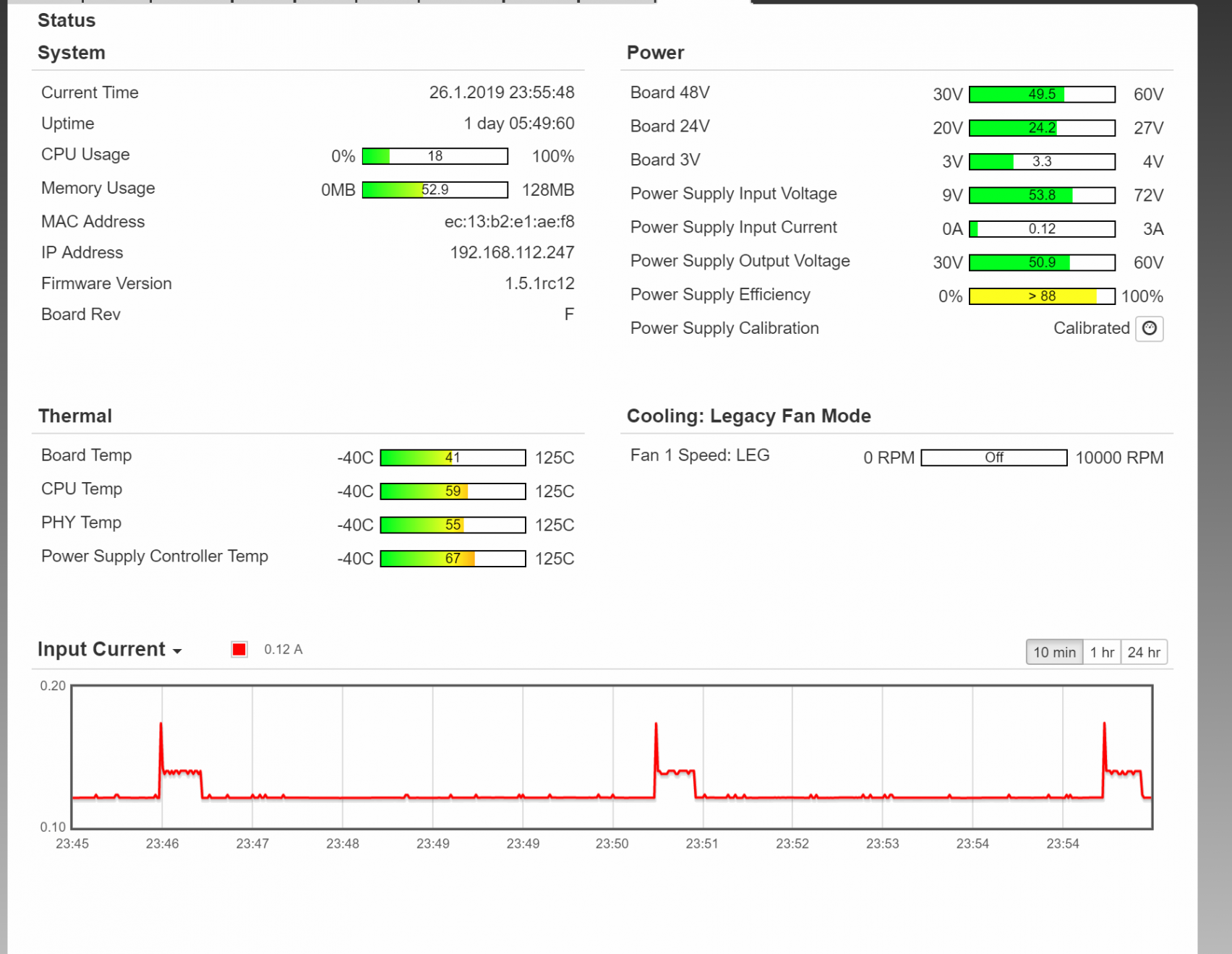

same here a WS-8-150-DC => the Fan Starts and Stops every few Minutes with full speed , then half speed and then it is off but it makes much more Noise it should
+1 for a Fix
here you can see it:
I EDITED YOUR POST AND ADDED THE PICTURE AS EXPLAIN IN MY POST FOOTERS - SIRHC
+1 for a Fix
Re: Possible low speed fan firmware?
ZillnerIT wrote:same here a WS-8-150-DC => the Fan Starts and Stops every few Minutes with full speed , then half speed and then it is off but it makes much more Noise it should
I was testing my WS-8-DC today on rc12 and the fan always came on at around 4K, never full speed.

ZillnerIT wrote:the Switch is a Brand New one, so it should not have bad fan bearings, (the Fan sounds ok but it is too loud when starting with max RPM)
With the new scheme the fan always starts at full speed or 8K for 1 second then slows down to 4K. We changed this behavior to help insure the fan does not get stuck on startup.
If your running v1.5.1rc12 or newer (v1.5.1 will be finalized soon) the fans work as intended).
We have tested these many many many many times for many many many hours.
Now sometimes the fan screws are too tight from our assembly line which can cause the fan blades to rub, just slightly loosen 1 or both fan screws a little bit until the blades stop rubbing. This does not happen often but can occur.
There are no bearings in these fans as I have expressed many times.
They are magnetic lev not bearings. This means the shaft is suspended by magnets not bearings.
If the fan screws are too tight then can cause the plastic fan chassis to slightly warp and twist which causes the blades to scrape the chassis, as I said just loosen them slightly.
But Monday or Tuesday I will again quadruple check the WS-8-150-DC fan behavior.
