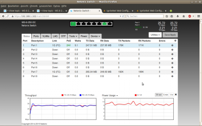

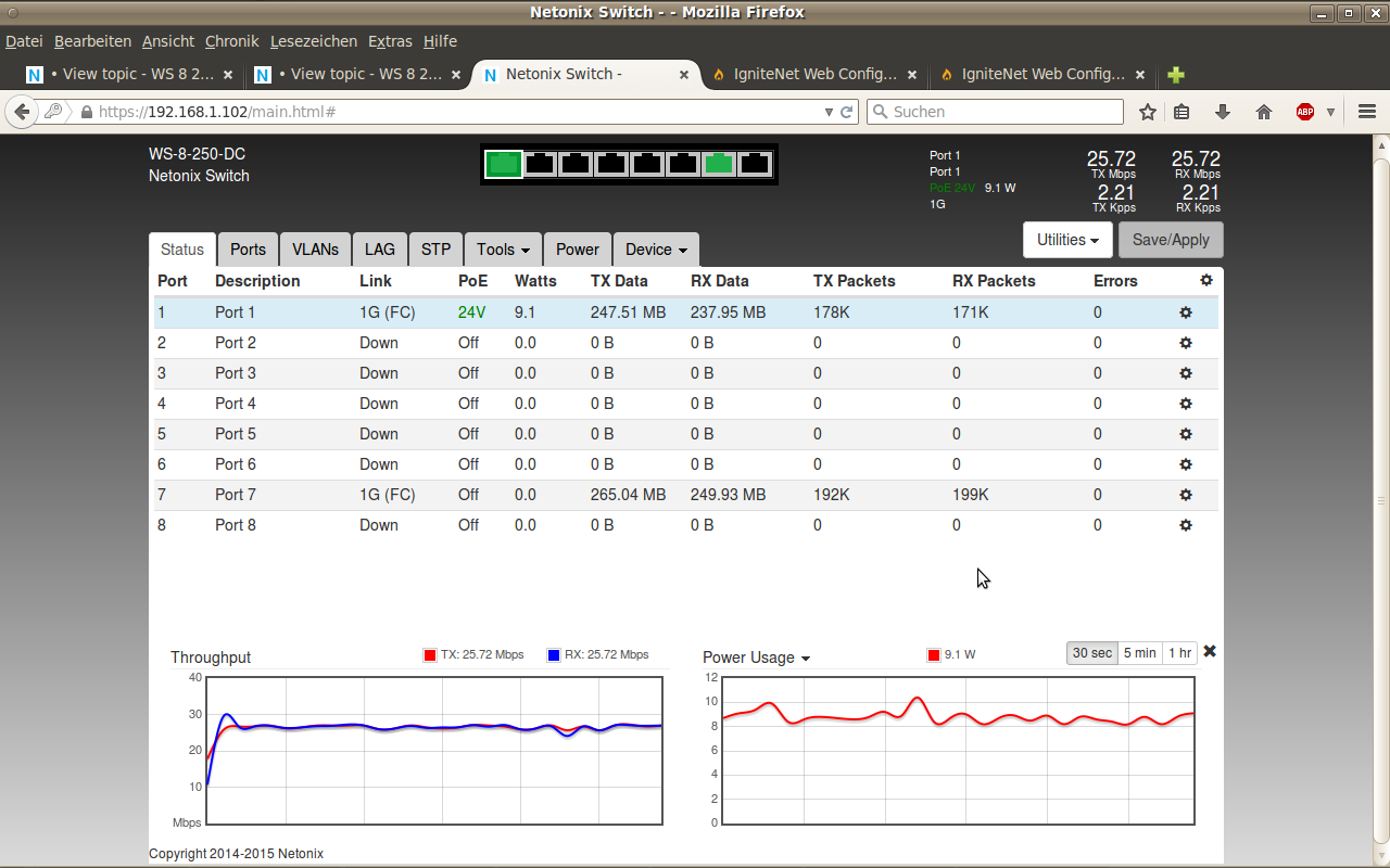

OK i ask because i read the pdf.
Should i give it a try with 24V 0.75 passive ?????????????
Re: WS 8 250 DC 24V 1A on Port 1 or 2
Tue Mar 15, 2016 3:57 pm
wlst wrote:OK i ask because i read the pdf.
As I said you "can" try, then watch the watts being used on the Status Tab and make sure it is less than 18 watts.
Report back what you see

Peak Power with link and little load ~12W
