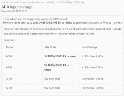

You need to be more specific when you talk about airFIBER radios
There many differnt airFIBER radios:
airFIBER 24 GHz which is 48VH
airFIBER 5 GHz which is 48VH
airFIBER 2X which was originally 24V or 24VH but now supports 48V and 48VH
airFIBER 3X which was originally 24V or 24VH but now supports 48V and 48VH
airFIBER 5X which was originally 24V or 24VH but now supports 48V and 48VH
READ THIS POST FOR EXPLANATION airFIBER 2X, 3X, 5X
viewtopic.php?f=6&t=1215#p9040
However with all that said YES airFIBER 2X, 3X, 5X with 24VH or 48VH and an airMAX AC radio with 24V is fine.
airFIBER 2X, 3X, 5X radios use about 10-12 watts at 48VH
airMAX AC radios use 4-12 watts
WS-6-MINI uses about 3-4 watts
So worst case 12+12+4 = 28 watts and the power supply is 50V 65 watts
Personally I would run airFIBER 2X, 3X, 5X at 48VH since they now support that voltage.
NEVER RUN airMAX radios with 24VH

Earlier I did say I had a af-5x radio and I'm not sure if mine is new enough to be able to handle the 48 I guess the older ones did not so I would have to research that I know the Poe that came with it was 24 so I feel safe to use that.
edit.
I am e3 2a is that later then e3 08 I assume yes. So I could go 48 ?
edit.
Re: Thinking of Netonix
Mike wrote:Earlier I did say I had a af-5x radio and I'm not sure if mine is new enough to be able to handle the 48 I guess the older ones did not so I would have to research that I know the Poe that came with it was 24 so I feel safe to use that.
edit.
Yes 04:18:D6:E3:2A:XX is higher than 04:18:D6:E3:08:E9
