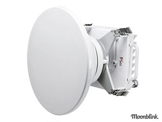

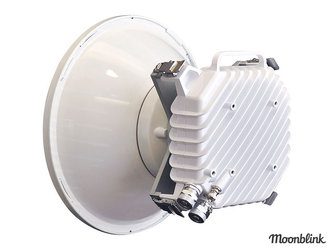

Exalt Extendair G2 works at 48VH
Exalt Exploreair works at 48VH
