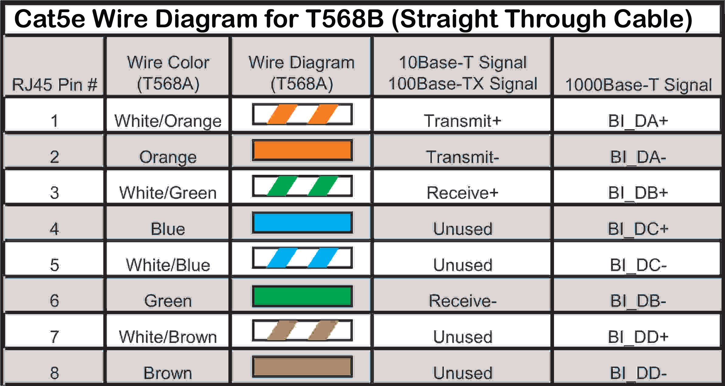

Can you please clarify / correct the original post.
In the first section it says:
"There are 4 pairs in an Ethernet Cable:
Pair 1: Green & Green White
Pair 2: Orange & Orange White
Pair 3: Blue & Blue White
Pair 4: Brown & Brown White"
and later on under Common Questions:
"There are 4 Pairs and 8 PINs in an Ethernet Cable:
Pair 1: White Orange.(PIN 1 ) & Orange.(PIN 2) is
POSITIVE
Pair 2: White Green...(PIN 3) & Green...(PIN 6) is
NEGATIVE
Pair 3: White Blue.....(PIN 4) & Blue.....(PIN 5) is
POSITIVE
Pair 4: White Brown..(PIN 7) & Brown...(PIN 8) is
NEGATIVE"
You flop pairs 1 and 2 (Of course pair numbers change depending on T568A vs B). Would be better written if only 1 standard is used in documentation.
As mentioned in the post, p17 of the Spec Sheet is the info I needed, and clear regardless of the standard being used.

Yes I corrected it, should be:
Pair 1: Orange & Orange White
Pair 2: Green & Green White
Yes, I am using T568B as my reference.
