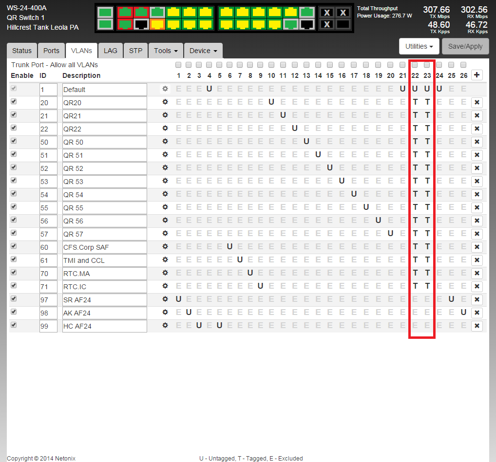

No, nothing should show up on the VLAN TAB when you define a LAG?
Read what I said in your other post on this: viewtopic.php?f=17&t=3362&start=70#p23019

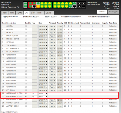

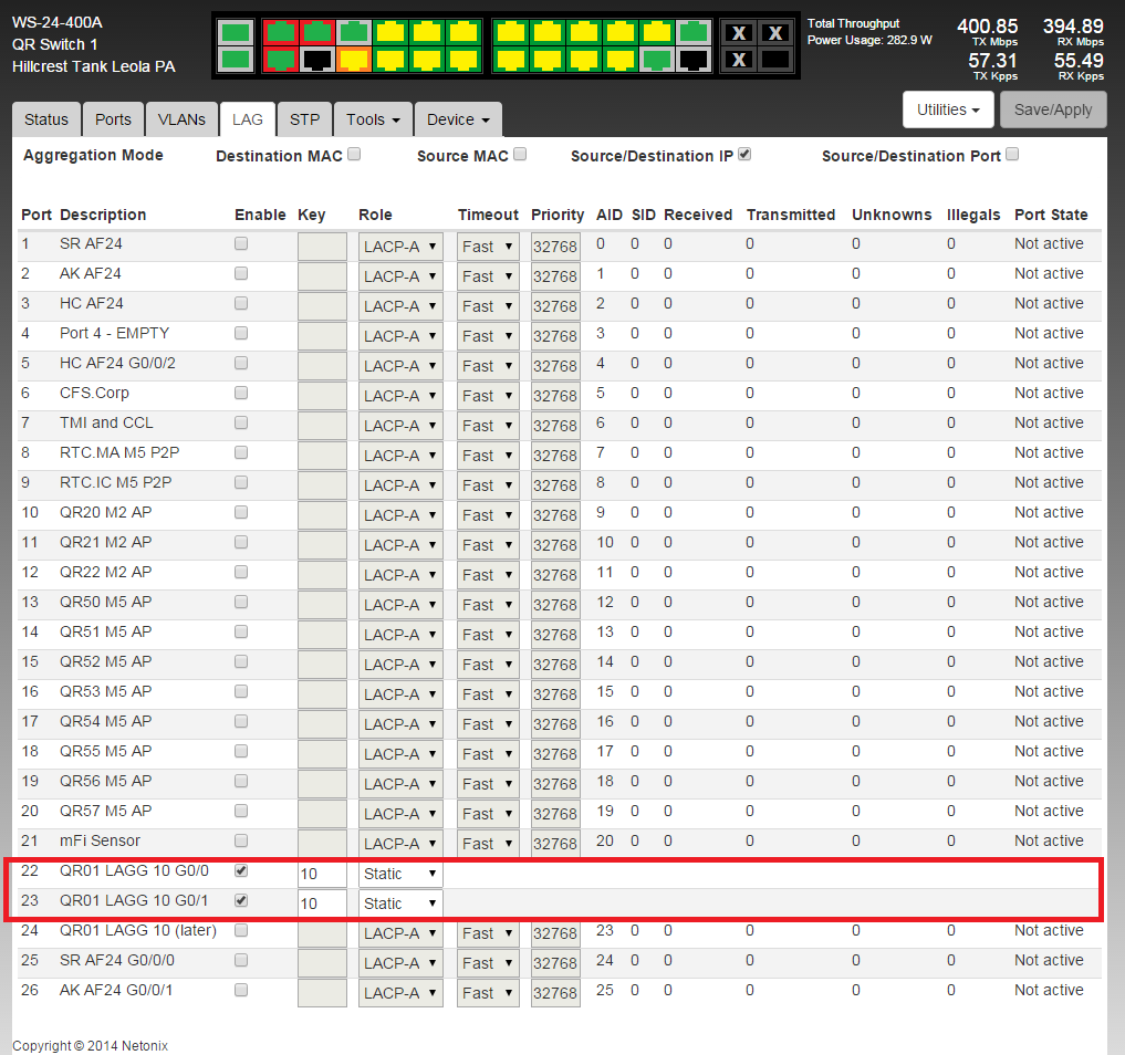

So below I defined a Static LAG, basically the same as LACP as far as VLANs are concerned:
Below is how I handled it on the VLAN TAB, pretty straight forward?
