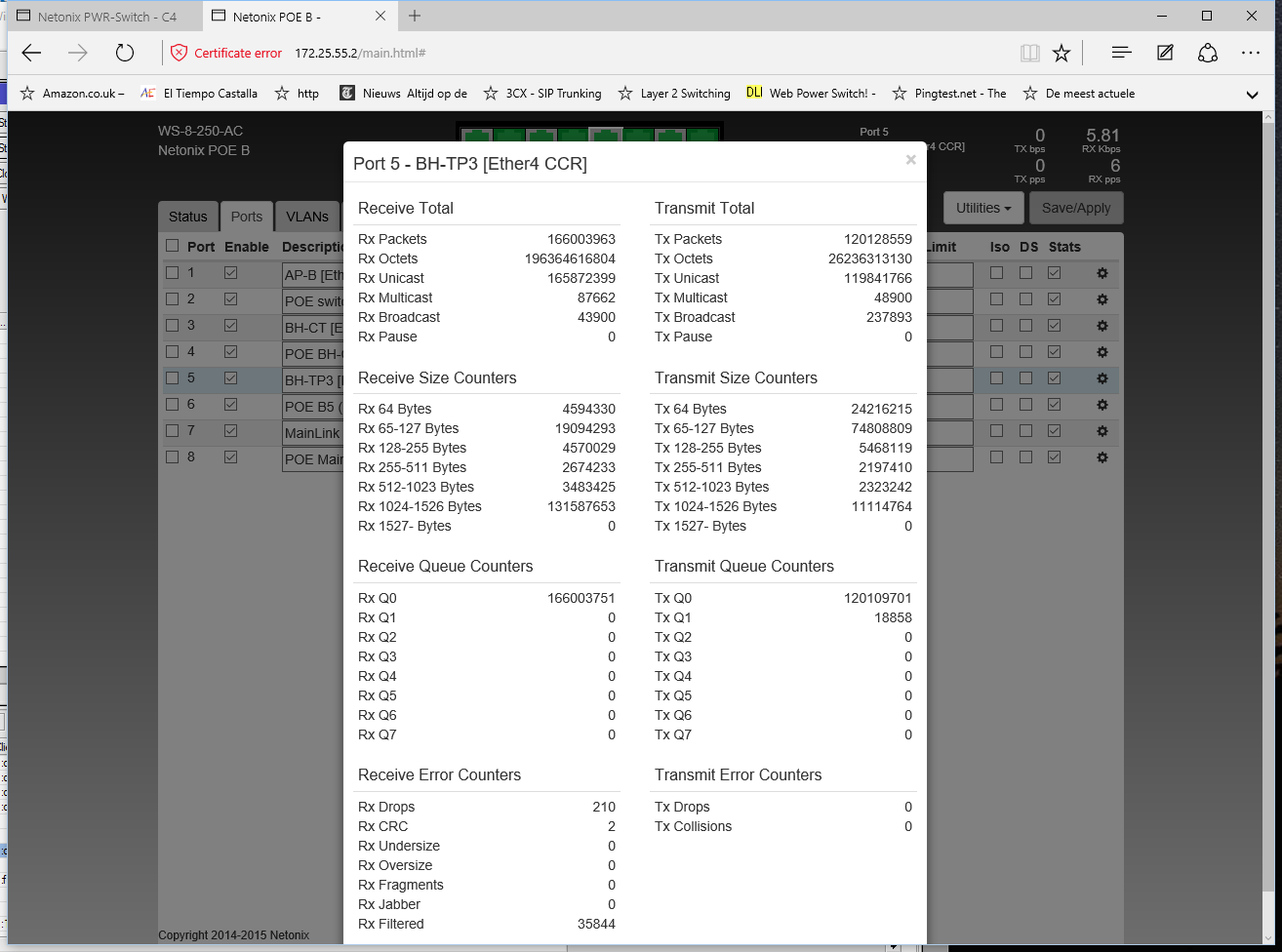

If you mean this;
Screenshot 2015-10-21 01.01.57.png (123.99 KiB) Viewed 55600 times
No, I don't see oversize. Checked the same on port 6, same result.
I have a ping running from the CCR to other end, so there should be packages (=traffic) send but the CCR shows tx traffic but rx stays '0'

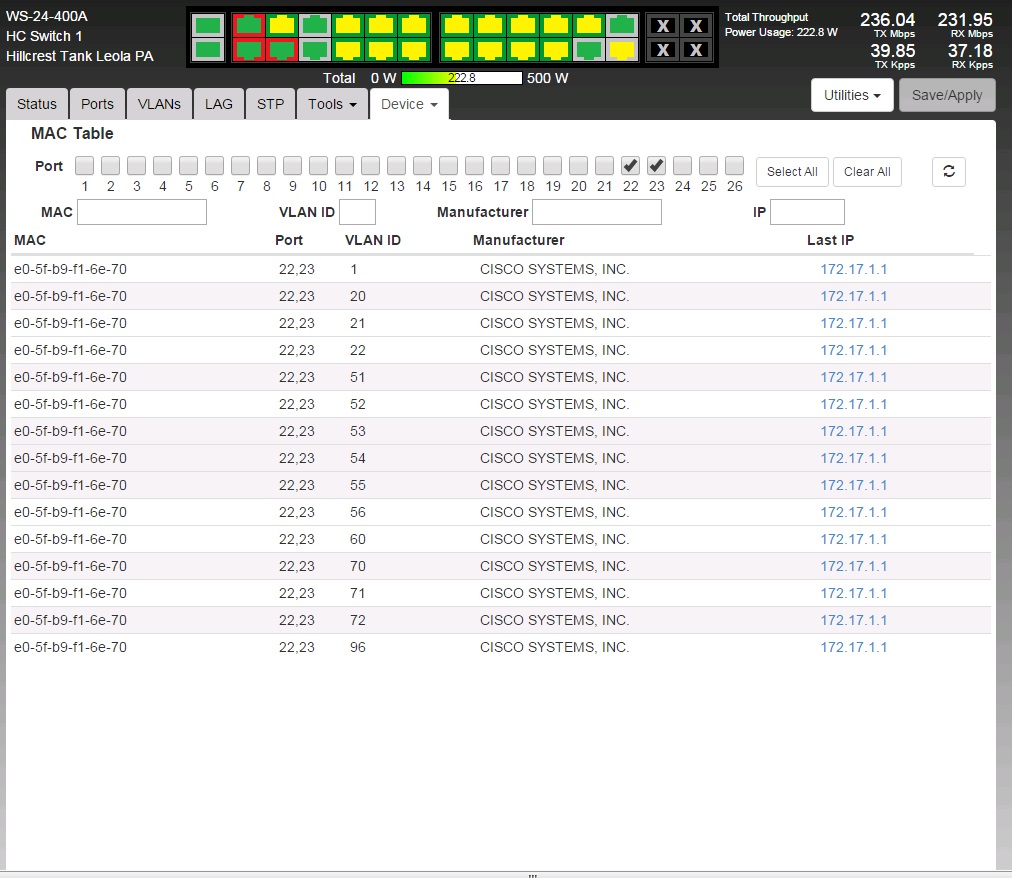

WirelessRudy wrote:Ok, we took a look in the mac table.
The port 6 of the switch that connects to a route towards some remote units that should get an IP (dhcp-client) through this vlan2000 are visible in the mac table of the switch.
The port 5 of the switch that connect to the CCR 'sees' the mac of the CCR interface twice.
If you have multiple VLANs or Sub-Interfaces (Logical Interfaces) plugged into a port on the switch you will see an entry for each VLAN on that interface.
Below are screen grabs from one of the WISP Switches at a towers at my WISP.
You can also see them in action here:
https://www.youtube.com/watch?v=8JvBEAD4MFM&spfreload=1
https://www.youtube.com/watch?v=cMv7JfG9cjI
Now I have a Static LAG between the Router and the Switch using ports 22 & 23 which is a little different but basically the same.
But notice the same Cisco router listed for each VLAN all with the same MAC but different VLAN IDs
I am not sure why you are running into this problem?
Ok, we sort of figured that too. Normal.
But your next screendumb are raising my eyebrows....
As you say your port 22&23 are aggregated ('lagged' or in Mikrotik I believe they call it 'bonded') so they actually work as one they have the letter "T" from "Tagged".
But if I then look at the other port that is supposed to be part of that switch combi (port 13 with ID 20 for instance) you have the letter "U" from untagged assigned to it?
This is then different than what you showed us before how it should be done... Both the 'incoming' as the 'outgoing' port in the combi have to have the same "T"ag or "U"ntagged?
I'l have to try this now. See who is first with an reply... :tounge: :thumbsup:

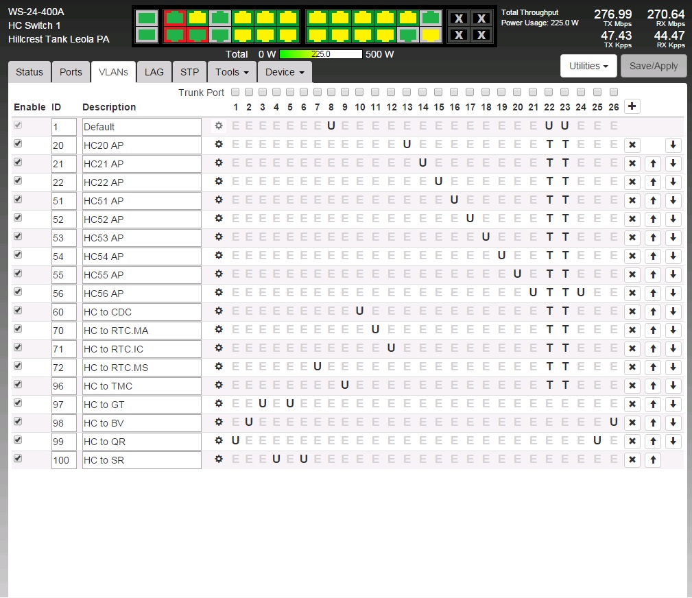

No, if you look at VLAN IDs 97, 98, 99, and 100 those are Bonded with just Us as they are setup as MID-Spans powering back hauls such as airFIBER links. The powered side goes to the radios and the unpowered port goes to the Router. Now since I run a routed network meaning no VLANs from tower to tower I use a U which will only accept Untagged packets. If I ran Tagged VLANs between towers I would use Ts on each port, and if I ran both Untagged and Tagged traffic between towers I would need to define two VLANs, one for Untagged traffic and one for each VLAN Tagged traffic or just one for Tagged VLANs and use the Trunk Port/Allowed VLANs list.
I Untag all traffic when exiting at an AP port so I do not have to mess with Tagged crap beyond the switch I tell the switch to Untag all traffic as it leaves the port connected to the AP. If I was using QinQ where I encapsulated VLANs inside the primary VLAN such as running say VLAN ID 200 inside VLAN ID 20 on port 13 with QinQ I would put a Q on port 13 that way the outer VLAN ID would be stripped off (VLAN ID 20) when the packet leaves port 13 and then I would have VLAN ID 200 intact on the packet and could then pass that through to a customer radio where I would then strip off the VLAN ID 200 at the radio since I run all customer radios in either router or router NAT mode to prevent them from getting Layer 2 access to my net, but if you had a radio in bridge mode you could strip that ID off at the customer router.

WirelessRudy wrote:So if traffic that already enters a port with some vlan headers (id=2000), the ingress port puts a new vlan header (the one from the switch, for instance ID=3 in my example) on top of it. So we have now a QinQ?
NO, the switch does not add a Tag to a packet entering the switch on a T port, it just only accepts a Tagged packet that matches the VLAN ID or from the Allowed VLAN List under Trunk Ports/Allowed VLANs. Or any defined VLAN on the switch for that port. You can have as many T's from different VLANs on a single port but only 1 Untagged per port.
If an Untagged packet enters a U port and the VLAN pushes that packet out of another Tagged port then the switch will add a VLAN ID Tag to the packet as it leaves the T port.
So in my situation above and all my towers as they are cookie cutters:
Talking about a client attached to say AP20 on port 13 which has an Untagged VLAN ID of 20.
Now when a client sends a packet to the internet the packet would come from from the AP and enter Port 13 of the switch as UnTagged, the switch would send that packet to the router out Port 22 or 23 (Static LAG) to the router. When that packet leaves Port 22 or 23 of the switch destined to the router the switch will add the VLAN ID Tag 20 to the Packet so the Router will know where to send it when it receives it. Since I am using a Cisco 2951 it is destined to a Sub-Interface which is a Virtual Interface not a Physical Interface. When the packet reaches the Virtual Interface the router will then removed the VLAN Tag and route it to its destination somewhere out on the internet or somewhere else in my network.
Now if a packet from the internet reached the router and is destined to that same client the Router Tags that Packet when it leaves the Virtual Interface and goes out of the Router and arrives at port 22 or 23 of the switch with a VLAN ID Tag of 20 so now the switch says OK this packet is headed out Port 13 according to my VLAN definitions.
Now when the packet leaves Port 13 of the switch which is defined as Untagged the Switch will strip off the VLAN ID Tag and then push it out port 13 to go to the AP. If port 13 had a T on it the switch would leave the packet VLAN ID Tag on but I do not do it that way and I want to stop messing with VLANs at the switch if all possible.
So in my config I am not using Trunking / Allowed VLANs so Ports 22 & 23 will only accept Tagged packets with VLAN ID tags of 20, 21, 22, 51, 52, 53, 54, 55, 56, 60, 70, 71, 72 and 96 from the router. Any packets with other VLAN Tags or no VLAN Tag would be dropped.
We are not doing anything differently with VLANs than any other switch, it is a standard. Now our interface is different maybe (simpler) but the way VLANs are handled is standard.
Now with that said some manufacturers turn the filters off to avoid tech support issues but that is silly. Why would you want a port that is defined as Tagged to accept Untagged packet and vice versa. But some manufacturers do this. They set their ingress filters to accept both which to the average person appears to work but you are defeating the purpose of VLANs.
Our ingress filters only allow what you have configured.
