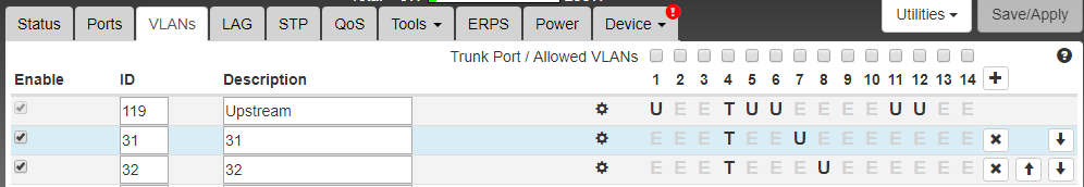

Hello, I'm trying to set up a vlan config as follows. My upstream requires using vlan 119 tagged out port 4. I would like to have ports on the switch separated in their own vlans that are then trunked into vlan 119. In the picture, the T on port 4 for vlan 31 and 32 should be double tagged with vlan 119 on the outside. I've tried every combination that I can think of and haven't been able to make it work. I've reviewed all the relevant posts on the forum and I am at a loss. I have this configuration working with two Mikrotik devices. Is this kind of thing possible with Netonix?
I'm running 1.5.0 on a WS-12-250-DC
To summarize, I'm looking to take different untagged ports and double tag them individually out another port. Thank you in advance.
Edit: To clarify, I need QinQ, not Double Tag

I need a QinQ tag. In my picture, traffic coming in port 7 is untagged, I need that traffic leaving port 4 with QinQ 119 on outer and 31 on inner.

schat wrote:I need a QinQ tag. In my picture, traffic coming in port 7 is untagged, I need that traffic leaving port 4 with QinQ 119 on outer and 31 on inner.
That's not how it works.
In your picture/screen grab above a packet coming in port 7 Untagged would leave port 4 Tagged VLAN ID 31.
Even if you put a Q on port 4 instead if T but had a U on Port 7 it would not work that way.
http://forum.netonix.com/viewtopic.php? ... inQ#p18225
http://forum.netonix.com/viewtopic.php? ... ged#p24872

mike99 wrote:
@Chris, what he ask follow standard, he would like to use both 802.1Q and 802.1ad at the same time on port 4 so
VID 31 & VID32 tagged (allowed) with 802.1Q standard and on the same port and immediatly after, add QinQ VID 119 with 802.1ad standard.
Yes, this
My use case is this; I have a remote site with a fiber connection. Over that fiber peering, I must use a vlan for that site to differentiate other sites on that fiber network. At the site, I have customers with direct CAT5 connections as well as wireless equipment for use in our network. I would like to be able to connect those customers and the fiber backbone directly to a Netonix and have that be the only piece of equipment needed.
