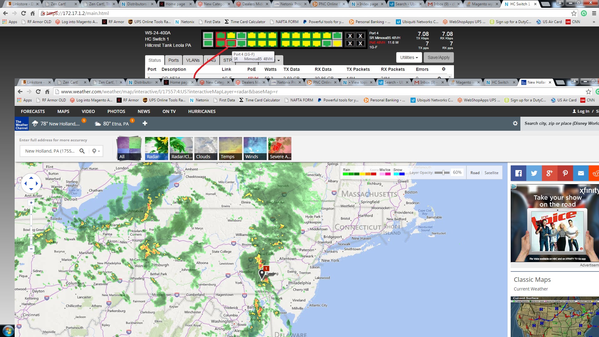

A storm just blew through here and dropped the temperature from 88F to 69F so I rebooted the MIMOSA radio and the Ethernet connection linked up at 1G again.

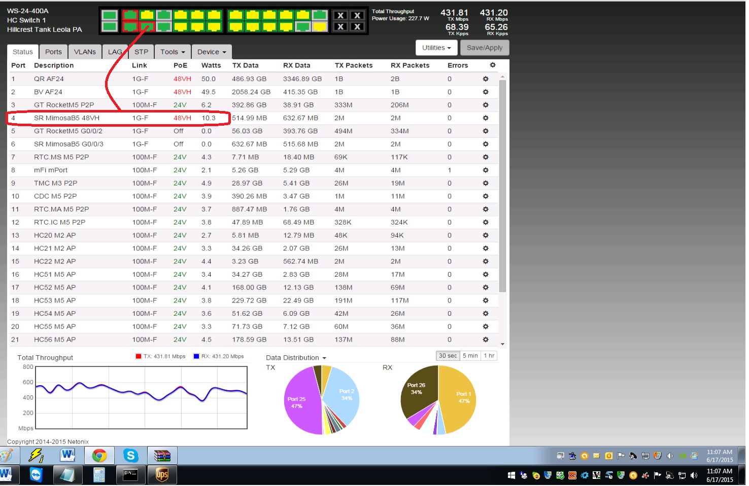

Now I had already tried the following before the temperature dop:
Downgrading the switch to v1.1.8 no effect so I upgraded it back to v1.2.2 again
Changed the POE from 48VH to 48V which rebooted the radio as I have to turn the POE OFF to change it from 48VH to 48V and no effect, still 100M
Changed POE back to 48VH which of course rebooted the radio again and the link remained at 100M
Now after the storm reduced the air temperature by almost 20F the radio's Ethernet connection now links up fine at 1G after a radio reboot. I am also sure that the grey conduit the wire runs in was much warmer than 88F as it was in direct sunlight. People do not think it but temperature effects wired communications as well, and even fiber optic to a very very very much less degree.
So what does this tell us, I am going to say that the added temperature reduced the characteristics of the copper Ethernet cable (dB loss or cross talk between pairs) which prevented the link from obtaining a 1G modulation.

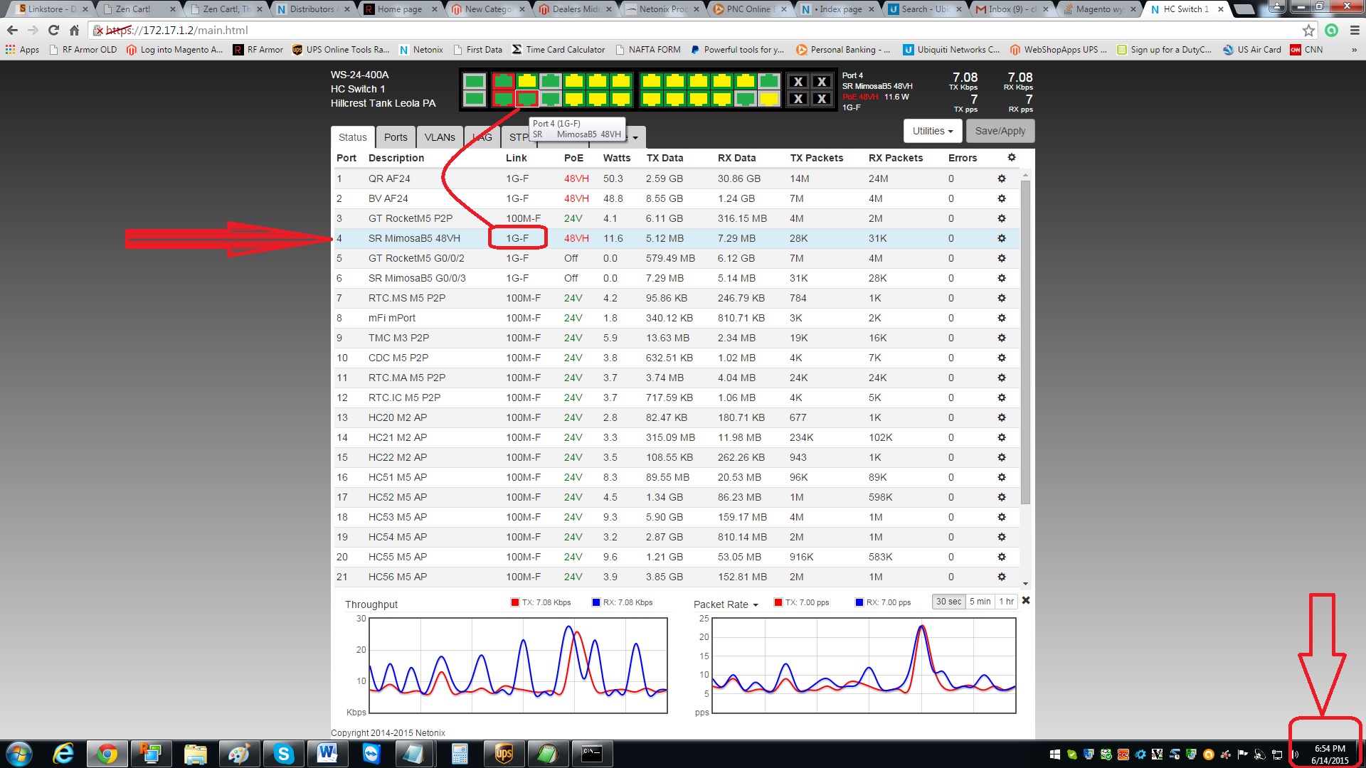

My tower crew got out to the site today and just re-seated the connections buy unplugging the RJ45 and then plugging them back in and for the time being the link is at 1G again and it is very warm today.
So this was one of my other initial suggestions that temperature can cause.
sirhc wrote:So it comes down to cabling and or the ends.
UPDATED CONCLUSION - NOTHING WRONG
So it appears after my tower crew re-seated (unplugged and plugged) the RJ45 connector yesterday the link has been maintaining 1G!
So there you go, nothing wrong with our firmware/hardware or their firmware/hardware and apparently nothing wrong with the cable either just a pesky RJ45 connector was unseated probably because if the wild swinging temperatures we had been having with plus or minus 20 degree F in very short time periods.
