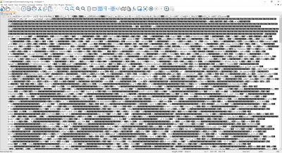

Hi Sakita, thanks for your reply. Yes I tried 7Zip and WinRAR and neither recognised the Netonix Manager config backup as an archive of any kind. I ran the file through TrID/32 File Identifier (with 19507 definitions in its database) and it said the file type was unknown.
So I'm thinking it's corrupted but I don't know why Netonix Manager would be storing corrupted backups or how to fix it. I'm attaching a screenshot of the file as viewed in Notepad++. It's very different from a config file downloaded directly from a WISP Switch which is mostly human-readable.
