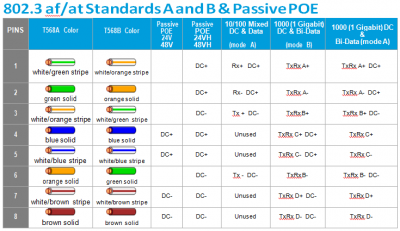

the ePMP POE is PIN (3,6)(4,5): +56V , PIN (1,2)(7,8): DC Return
from the research I have done this is reversed and would damage the radio?

The ePMP 4500 series uses a standard ePMP PoE pinout, where V+ (positive voltage) is on pins 7 and 8, and Return (negative voltage) is on pins 4 and 5. This is in contrast to the 802.3af PoE standard which uses pins 4&5 for V+ and 7&8 for Return. The ePMP 4500 also supports a voltage range of 44V to 59V, according to Go Wireless NZ.
So yea, they did it ass backwards from the STANDARD

It's doable, I'd recommend getting a few of these. https://www.balticnetworks.com/en-ca/pr ... hDNqBwpKef This will reverse the polarity and prevent things from blowing up.
We have a bunch of 4500/4600s powered up at 48v with no problems.
