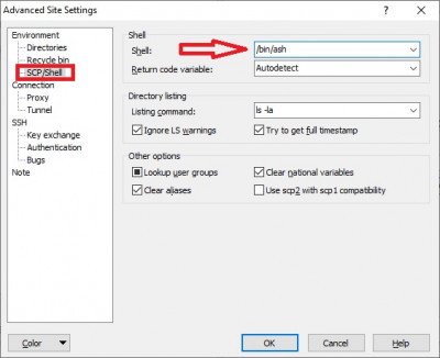

Background: WinSCP won't automatically work with Netonix switches because of the custom CLI that loads by default.
Solution: To make it work, you simply need to manually specify the Shell in WinSCP as /bin/ash before connecting:
1. In the WinSCP Login window change the protocol to SCP then click the Advanced button
2. Select the SCP/Shell menu on the left.
3. Change the Shell option from Default to /bin/ash (You'll probably have to manually type it in.)
4. Done!
