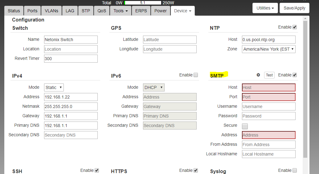

For smart DC units, like the WS-12-250-DC for example.
You can go to the Power Tab and change the Warning Voltage so that it will log when the voltage drops too low.
If you set that up and SMTP in Device->Configuration then the switch will send you an email when the voltage drops too low.
Power Tab to set Warning Voltage:
SMTP Config for Email notifications:
