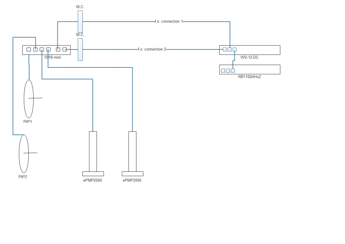

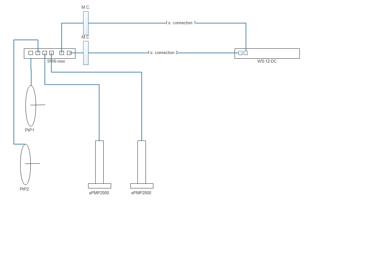

we are doing a new wisp site like diagram attachment; at first we was thinking to connect the the wisp switch with only one fiber optic cable and separate PtP and AP traffic with vlans. After that we read and remember that we could have problems with pause frames! So we decide to separate PtP and AP traffic on 2 different F.O. and inside those separate traffic with vlans.
The question is , can this configuration be usefull and full functional for us or we have to connect each PtP in midspan to phisically separate the traffic ?

Separate what from what ? Where the router ? What is the WS-12-AC use for ?
If no router, disable flow control. If router on remote site, please make a diagram including other site.

Sorry,
now I have added the router; we are on the same site (roof) but we have 2 mast, one on one side and one on other side of the roof; on one mast we have 2 AP and 2 PtP with one WS6 and on the other side we have the WS12-DC, RB1100AHx2 and the ePMP2000 sector. If we connect 2 f.o. from ws6 to ws12 we would separate traffic of the APs and the PtP.
The question is the same, can be a useful setup or we have to use more than two f.o. connection to have a midspan for each PtP ?
Thank you.
Thank you.

I would separate the AP and backhaul traffic as in picture below.
But I already show this in this thread: viewtopic.php?f=30&t=452#p2961
And in fact there is a link in that thread to a 1.5 hour video tour of my WISP and I talk about this very question if you watch the movie.
To be honest I separate each backhaul from anything else with a midspan to a router port to insure no backhaul can affect the next backhaul, traffic coming into and out of tower. But depends on how much traffic your passing.
Watch my video.
Watch my video.
