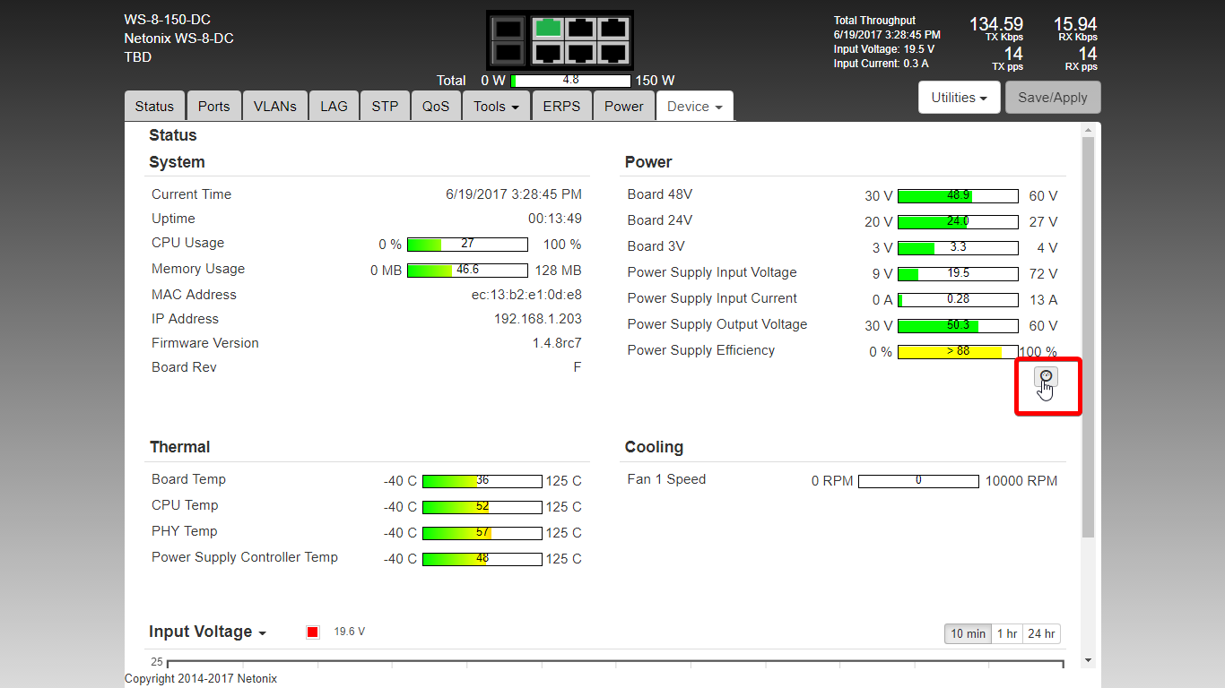

Under Device > Status > Power, there is what looks like a dial that changes the pointer and background on mouseover before it is clicked but not after clicking it. Clicking it does nothing as far as I can tell.
What is this?
Re: What is this?

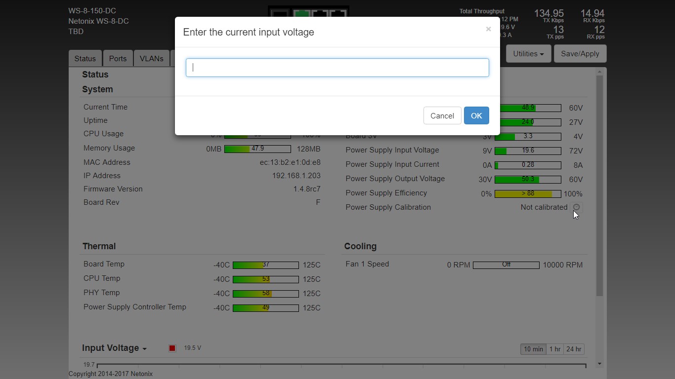

OK, I swear that I hovered over it until the cows came home and didn't get a tooltip. Of course, just after posting, I now see the tooltip "calibrate" and the words "not calibrated" to the left of it. Also, now clicking it brings up an input box.
