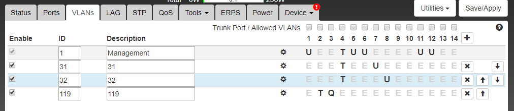

QinQ Untagging Double VLANs
Re: QinQ Untagging Double VLANs
It's to Eric or Chris to confirm but I'm pretty sure you can't.
Eric Stern - Employee
- Posts: 532
- Location: Toronto, Ontario
- Been thanked: 130 times
Correct, the current software cannot do this.
However, with some creative configuration I think it could work. Configure it like so:
Move you upstream connection from port 4 to port 2. Use a patch cable to connect port 4 to port 3.
When the untagged customer packets arrive on port 7 (for example) they will be sent out port 4 tagged 31. These packets will arrive on port 3 (the Q port) and will then be sent out on port 2 as QinQ with the outer tag as 119.
In the other direction QinQ packets with 119/31 will arrive on port 2, the outer tag will be stripped and it will be sent out port 3 with a single tag of 31. When this arrives at port 4 the 31 tag will be stripped and the untagged packet will be sent out port 7.
This uses up a couple more ports on the switch but it should work for you.
In the meantime I'll see if there is a way to do this in software.
