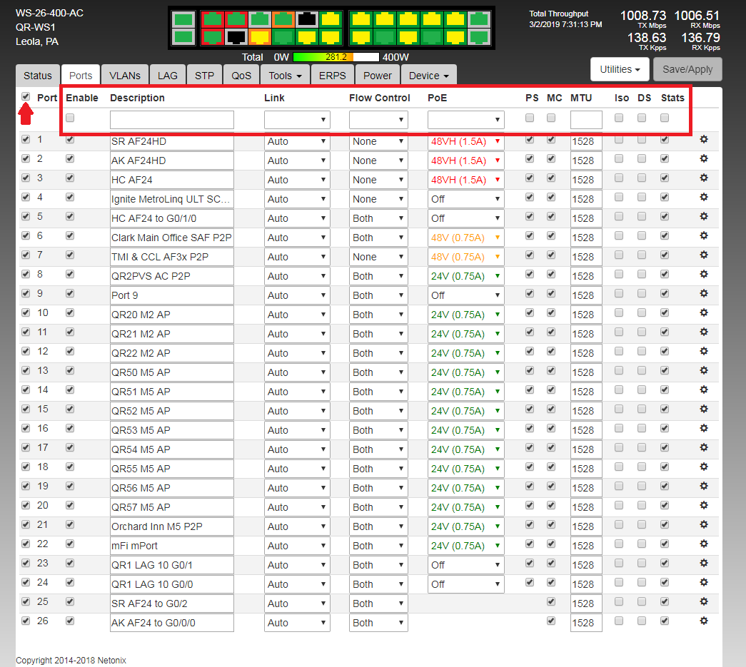

Hello,
I would like to request a software feature: the ability to set all ports MTU to maximum at the same time. Maybe a check box at the top or bottom of the page that when selected would accomplish this task.

Look at the picture below. You can select ALL ports with the top checkbox the red arrow is pointing to then deselect undesired ports or select desired ports separately with the check boxes on left of each row.
Once you select a port or all ports with the box at the top left corner shown by red arrow a row appears at top shown in red square pushing all ports down. Now simply put the value in you want all designated ports to get.

Re: Feature Request: Set Max MTU on all ports at once
That check box escaped the notice of my eye until now
Thank you for the info
