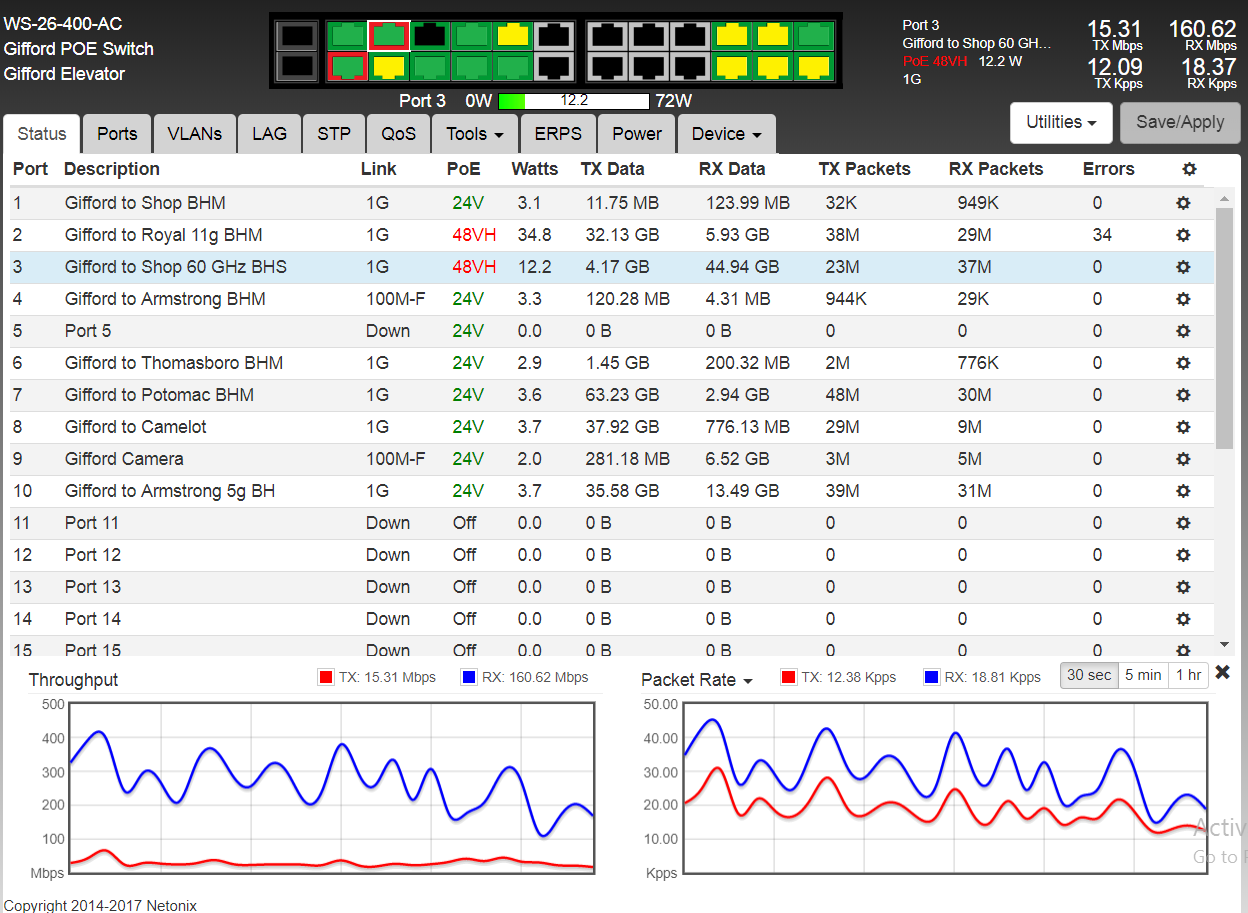

I am looking at your pictures, you showed me a screen grab of the upper right corner of the switch UI showing port 3 you did not show me a graph of port 3.
As I said we have been down this road several times where people questioned the graphs and in the end they discovered their error.
All we do is take a snapshot of the port statistics every second and compare it to the previous snapshot and calculate the throughput and store them in an array. There is very little chance to get that wrong.

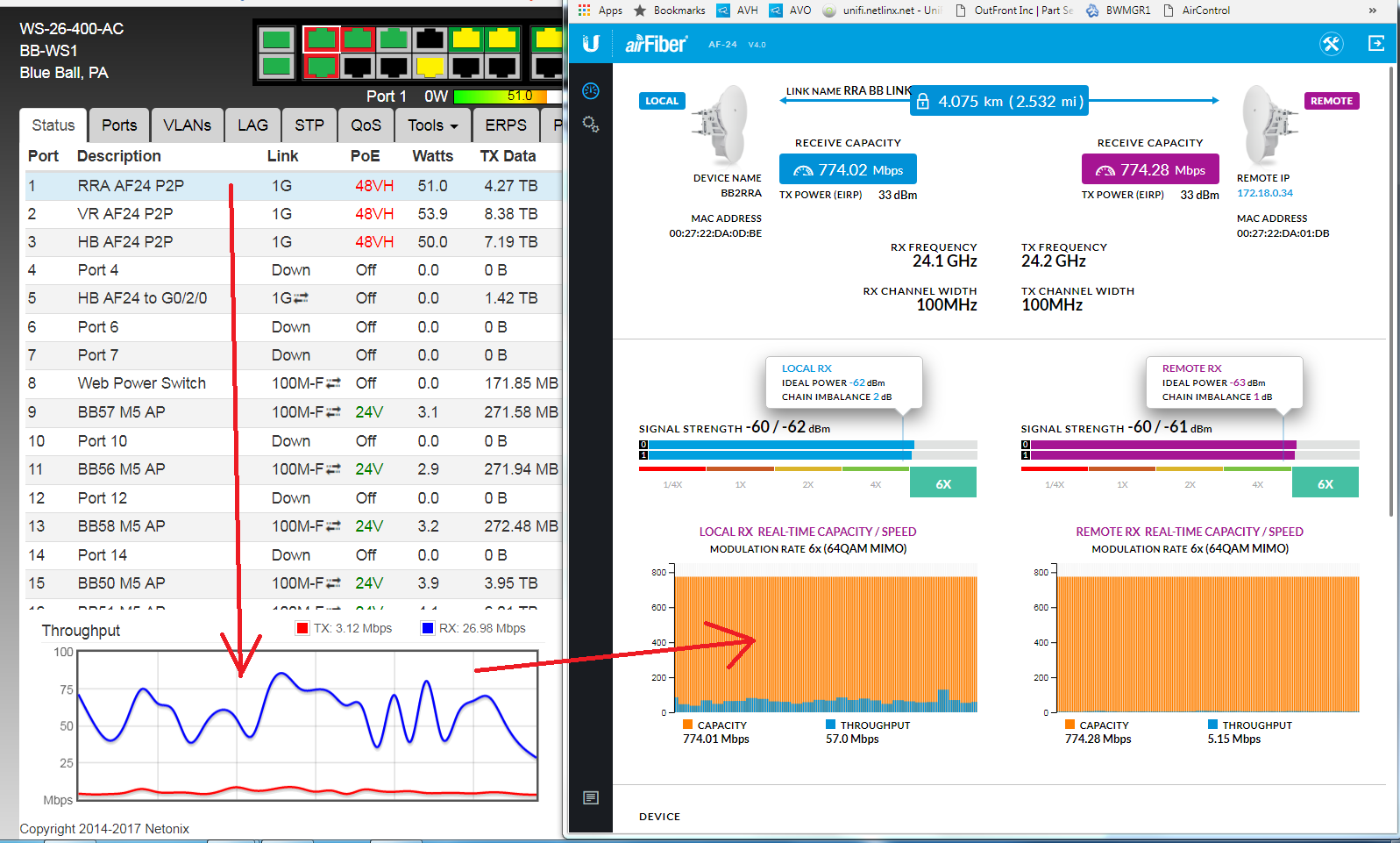

I did go double check my switches last night and confirm they are reporting correctly. If you look below you can see I selected port 1 which is the port connected to the AF24 radio. The graph corresponds correctly to the traffic coming across that AF into and out of Port 1

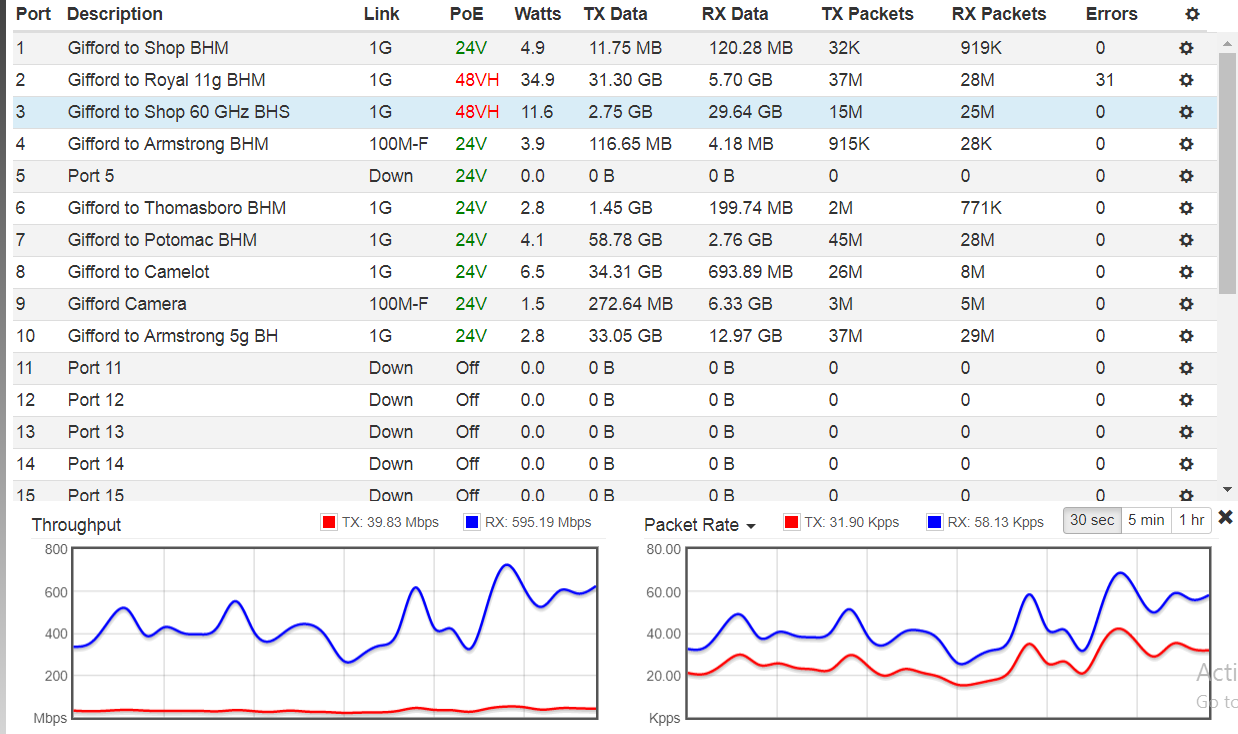

As far as the graph goes, are you telling me that when you click on the port on the status page, that the reading at the top right isn't for that port? Even though it says it's for that port?

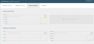

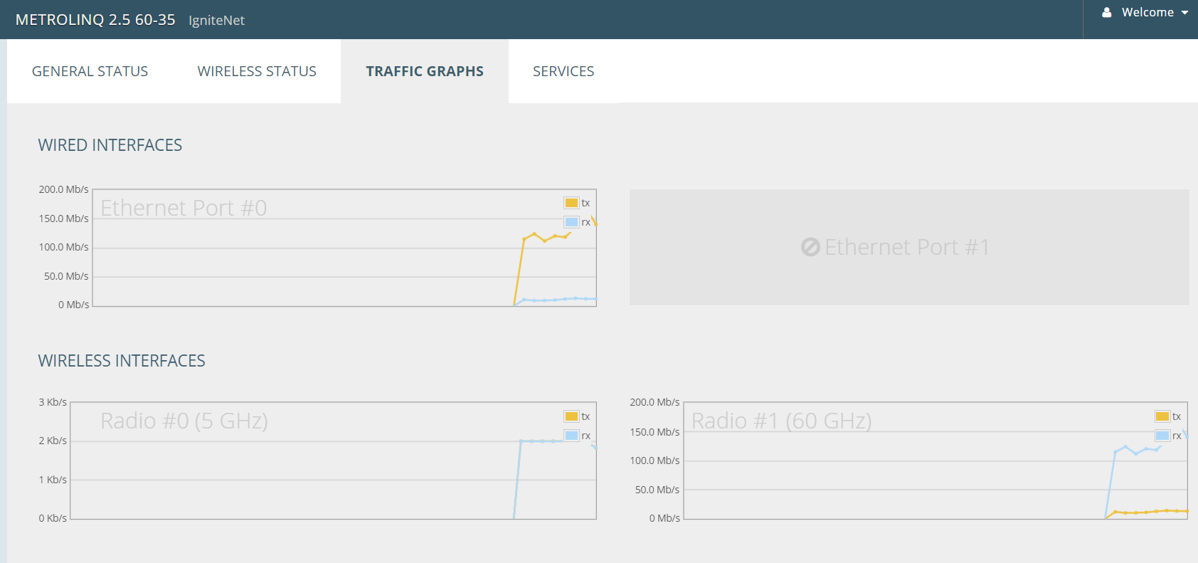

So here is the GRAPH from the throughput of port 3, and the GRAPH for the BH that's on that port.

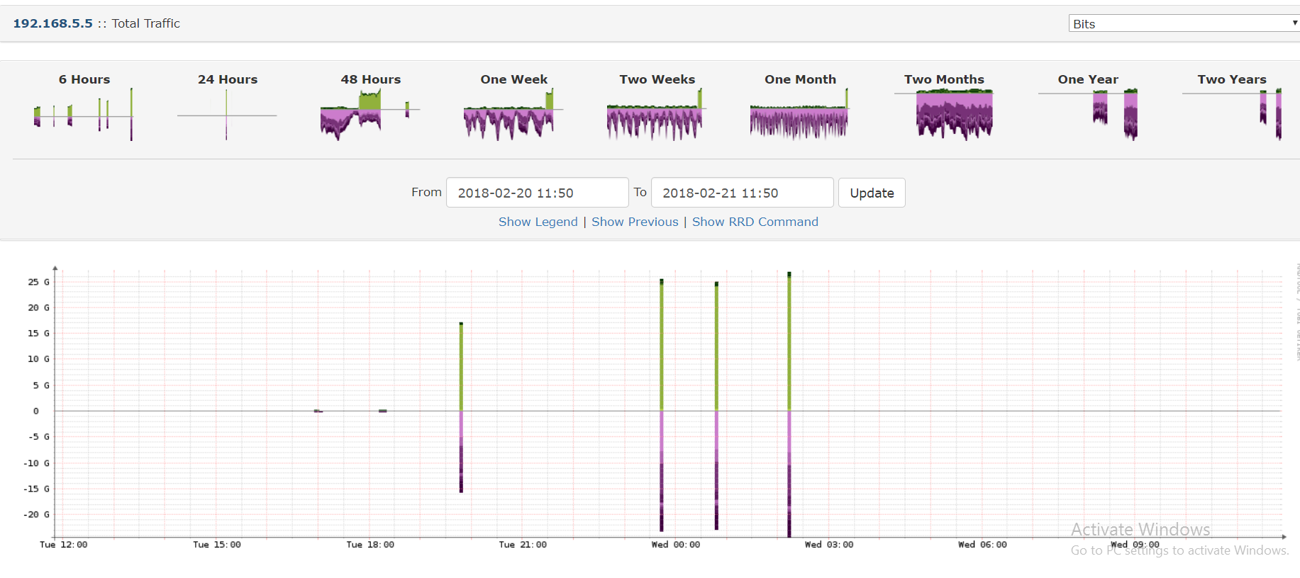

So you can see, the BH is saying there's about 150-200mb of traffic, while the Netonix is showing 600-800mb of traffic. I don't even have 800mb of bandwidth available... LibreNMS shows the switch running 26GB at times.

The picture I posted earlier, in my second set of pictures, I captured the top right corner of the switch showing PORT3's throughput, you said that wasn't good enough and you needed the graph. Just so we are clear, when you click on a port on the status page, THAT port's throughput is shown at the top right in the screenshot I took for you. It's the same readout as the pretty graph at the bottom. So I'm not sure why you couldn't use that screenshot. So here is another one, of port 3, with the top right corner AND the graph. See, they are the same.

Look you egomaniac, I'm not saying your switch is bugged. But I AM saying that it's showing traffic that's not being generated from my network and is flowing nowhere else but ON THIS SWITCH. All the backhauls connected to it show one amount of throughput while the switch is now showing between 2x and 3x more than what the backhaul shows.
As far as trying to power down the ML and use the old backup, I just tried it. Same thing. BH shows about 150mb throughput and the Netonix is showing 300-500mb of throughput.
