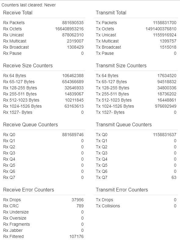

Okay, so it just happened again and it looks like a router (R1) just rebooted and in doing so both R1 and R2 are showing VRRP in backup state - neither is master. I went ahead and took a screen capture of all the tabs requested and attached.
At this moment for Example - the radio on Port 5 is NOT accessible - connected directly to the switch. I can login to the radio at the remote site and it shows that the link is operational and passing 127 Mbps of traffic.
The thing is once I reboot the switch the VRRP states of active/backup will likely start working just fine and I'll be able to access all the radios without any other action taken.
I also included the port detail for Port 5 as a reference.
