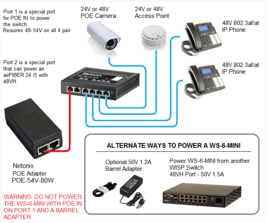

Short answer: YES you power it with 48VH POE option from the a WISP Switch
Answer in pictures:
