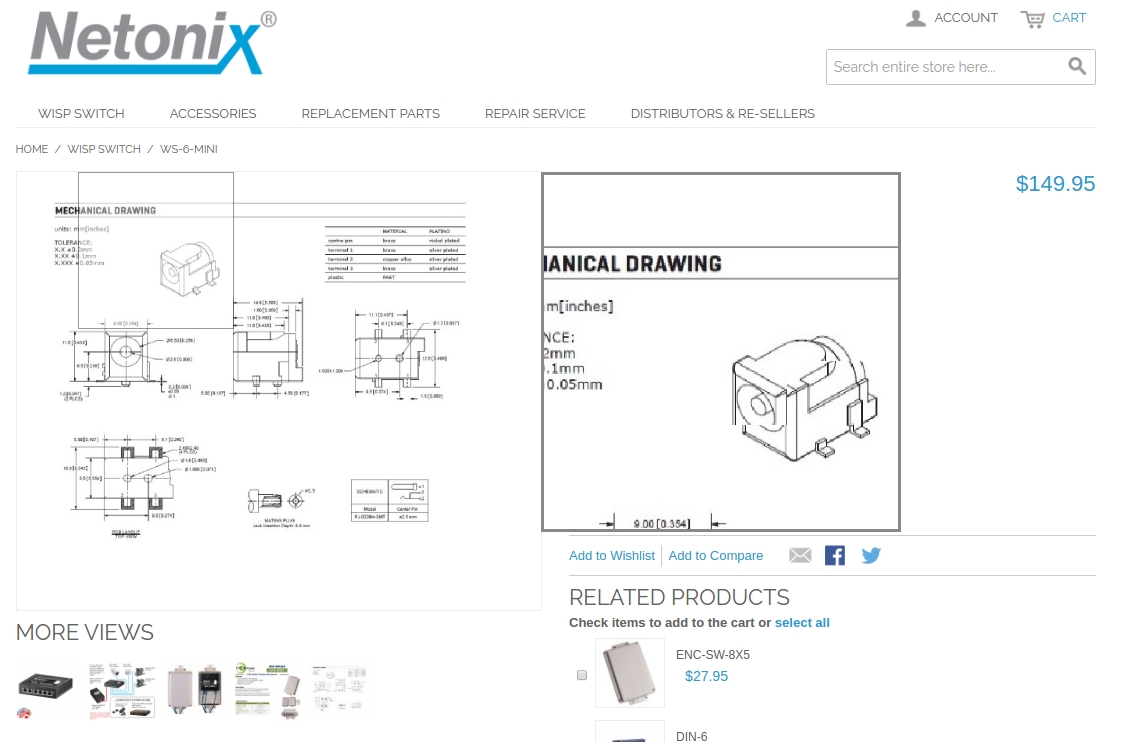

What is the correct dimensions for the power plug on the WS-6-MINI switch ?

Had to search on "barrel connector" and scroll a bit, but: viewtopic.php?f=17&t=722&hilit=barrel+connector&start=10
sirhc wrote:Well they say
Output : DC 48V 2A / 2000mA 96W
Out put adaptor jack size 5.5mm x 2.5mm
the adapters Connector inside positive (+)outside negative (-)
So Polarity is correct, center pin (+)
And our center pin requirement is 2.5mm
Should work.
EDIT: See also the mechanical drawing here https://www.netonix.com/wisp-switch/ws-6-mini.html

Or you could just click on the image in More Views. :willy:
