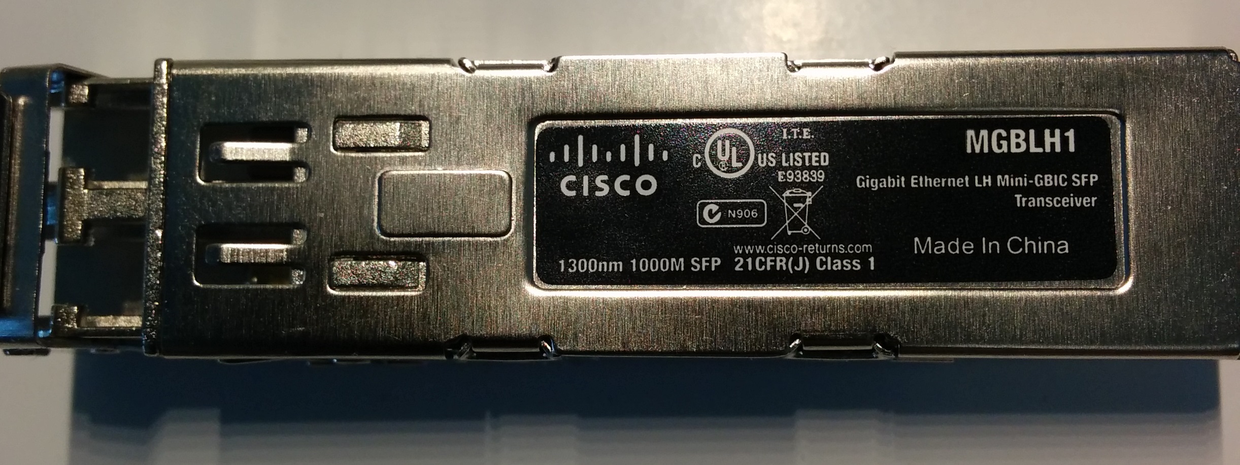

Has anyone used the Cisco MGBLH1 Gigabit LH Mini-GBIC SFP transceivers to link two WS-12-400-AC switch and worked?
Fiber Specs: 6/F 8.3/125 single mode fiber

It was nice talking to you on the phone the other day. I spoke with our Engineer and we have asked our software engineer to order (2) of these modules to test with out switches.
I am 99.9% sure they will work as I said as they are Cisco compatible.
If by chance they do not work with the current firmware Eric will see what he can do.
As I said working with Marcus from Verizon a software feature he requested is in the v1.4.0rcX firmware so when you get your test units I would recommend installing v1.4.0rcX first before you start playing.

Re: WS-12-400-AC switch and Cisco MGBLH1 SFP Transceiver
Tested these modules today, they work fine.
