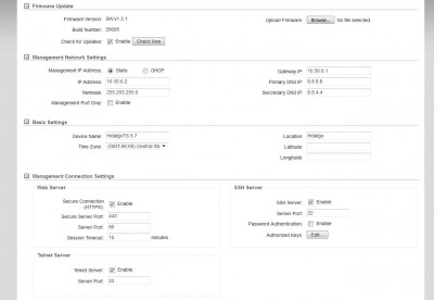

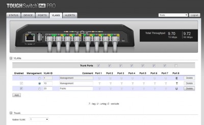

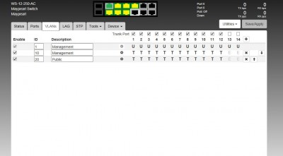

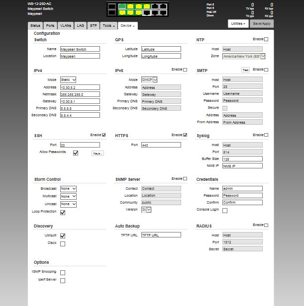

Could anyone help with my situation. New to the product, and we have been changing out our toughswitches with the Wisp switch. We cannot see why the Netonix switches cannot be accessed through cmd line or through the GUI when trying to access them remotely. We can access all tough switches that are still in service. Any help would be appreciated. I have attached pictures of the setup.

Because with our switch the TOP VLAN, the one you can not delete but can change the ID and Description, is the Default/Management VLAN and the only VLAN that switch UI/CLI will respond to.
Simply change the Default VLAN ID from 1 to 10 and there you go.
Just because you created a VLAN and gave it an ID of 10 and named it Management does not mean our switch will respond to the VLAN. THe description you put in is for human reference and does not mean anything to the switch.
UBNT just gives you the option to change which VLAN the switch UI/CLI responds to which is sort of silly in my opinion. Since the switch will ALWAYS need one VLAN why not make that VLAN the management VLAN and undeletable and always at the top of the list or so we figured.
Also you do realize you might as well not use VLANs when you make every port a Trunk Port and tell it to pass all VLANs.
The whole idea of VLANs is to segregate traffic which you are defeating this concept.
