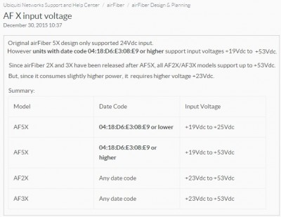

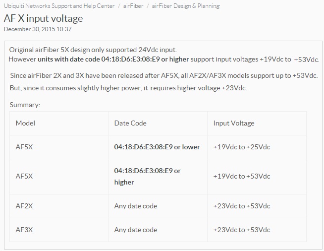

alohabro wrote:We have a lot of AF5x running at both 24vh and 24v. They seem fine.
We just put up one AF2x link, and we had a lot of trouble with it, until I realized my tech plugged it into a toughswitch! Replaced toughswitch with a netonix running 24vh and its been working good.
But if I can change it to 48v, that would be even better.
For the 2x, does it support 48VH and 48V?

We swapped some rockets to AF5X not thinking about what ports they were connected to on the WS (24v .5) they both worked for several weeks. After awhile one of the ports would start dropping to 100Mb instead of 1Gb.
This morning we had power on one port but no ethernet link. I turned the port off and set to 45v .5 amp and the radio came right back up and is operating normally.
The other link was also on 24v .5 and I shut it down and moved it to 48v .5 amp. Hoping that it stops dropping to 100Mb now.
I can only assume that since we were pushing the port's power limit that it was causing issues. will report if anything changes.
I will probably move one of these to a second switch we have at the site that has VH ports but for now this works.

Re: Confirm AFX Radios POE
Tue Mar 15, 2016 9:53 pm
So just to re-cap on this thread, the 'newer' AFX radios that support up to 56V, can actually be run on any of the 24, 24VH, 48, and 48VH? That's a crazy amount of variety. Short cable runs, 24V, and long runs, 48V or 48VH? Should the old-style AFX's be run on 24 or 24VH? I have many that I am powering off of regular ToughSwiches that will be converted to Netonix soon, and just want to be sure.
Tue Mar 15, 2016 10:00 pm
OLDER AF5X
24V .75A up to 180' +/- of cable
24VH up to 326' cable
NEW AF5X
24V .75A up to 180' cable
48V .75A up to 326' cable
48VH up to 326' cable
