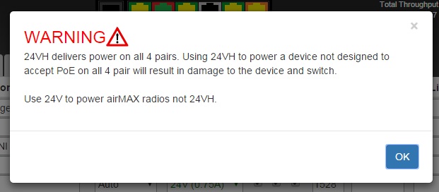

10-4 well so far I like it. I haven't put in field yet but Im thinking of getting 1-24 port and some more mini 6. Pictures show an 8 port but you probably don't make them anymore? Also if it were me, on that label on the 6 mini (or others) I would have port 2 labeled HI Voltage Only 4 pair power or something to identify that port. What happens as you know Im sure, Something happens at a tower site and you call closest tech to go check it out and he gets there and moves into a different port or something and POOF! there goes the radio so now you call the climber hehe In this case where you have a specific port just for the 8 wire power it could be labeled so.

Well if you are up to date with your firmware then if your tech tries to turn POE on Port 2 he will get this warning:
