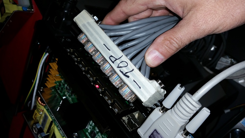

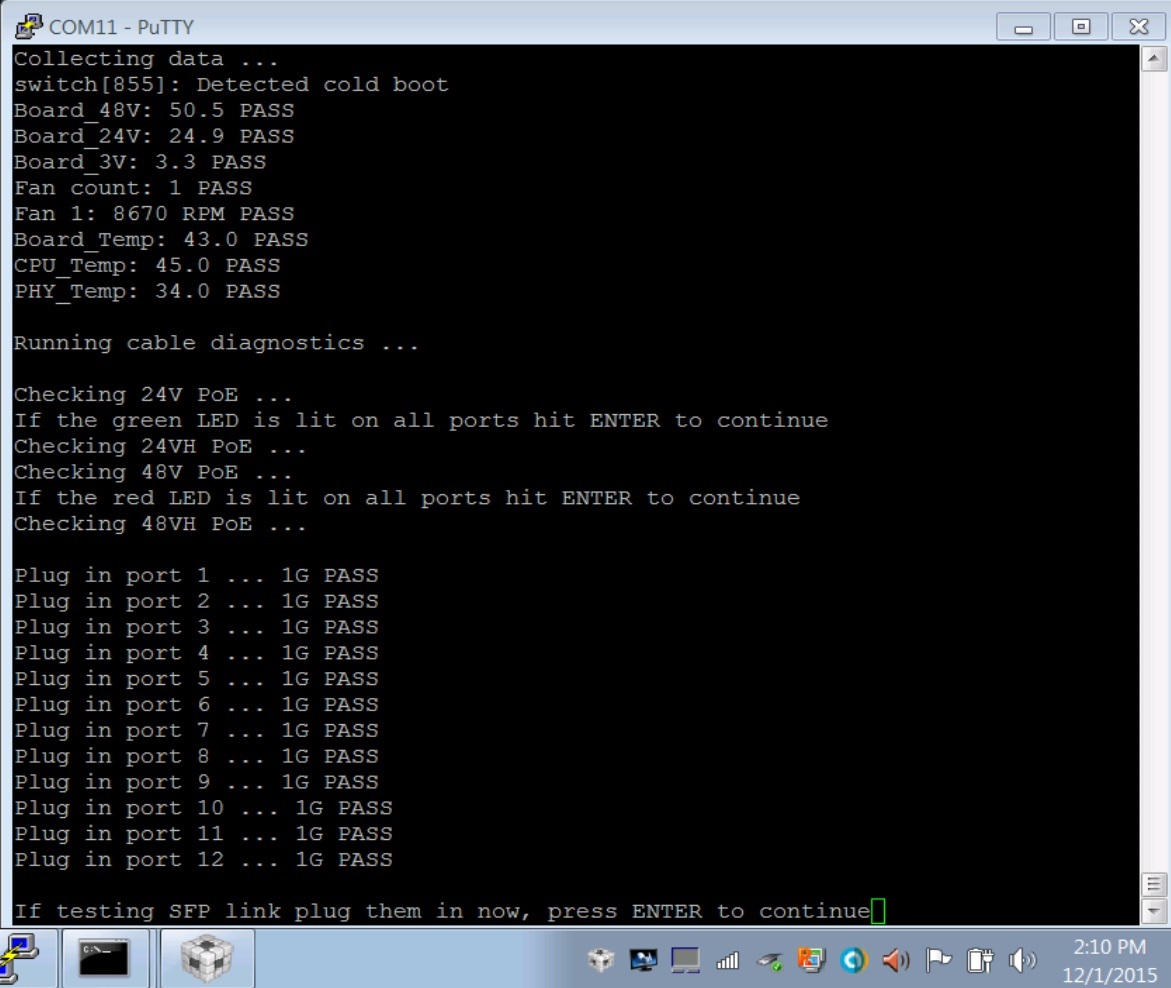

The parts are assembled and sent to the testing and serialization station where we assign the MAC and enter it into inventory. Up until recently each switch was manually programmed with its firmware at this station but we recently changed to where the switch PCB now comes pre-flashed with it's firmware but is NOT assigned a real MAC address nor is the label printed for the chassis or the box nor at this point does the switch even know what model it is so it will not even work properly.
Each switch is fully tested at this station, the following functions are tested (see image below of the test screen):
Each Ethernet port is checked to achieve a 1G connection. <== Ports do not come DOA
Each port has it's POE ability checked.
All current, voltage, and temperature sensors are checked. <== Current sensor failure is from exposure to voltages > 80V DC
The POE LED's are checked.
If the unit is a SMART DC model the power supply telemetry is checked.
The power supply is tested obviously as the switch would not boot if it did not work.
During this testing phase the unit is rebooted 2-3 times. <= Units do not come DOA
The testing software is built into the firmware and we are connected to the serial port. If it is a WS-6-MINI there is an internal console header we attach to as the chassis is open at this phase of testing.
Since the software to assign the MAC address and do this testing is built into the firmware it is impossible for a unit to leave here if it does not boot.
If the unit fails any test during the testing phase the software will NOT allow the device to be serialized. Currently the user must key in or paste the MAC into the console but we are working on automating this procedure as we have had a few user errors where the operator duplicated the previous MAC.
Finally the software assigns the MAC address and the operator cold boots the device for a final check. At this point the operator is plugged into port 1 and the software that prints the label that goes on the chassis and the outside of the box must see a ping to the default IP address or the label does not print.
