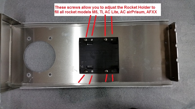

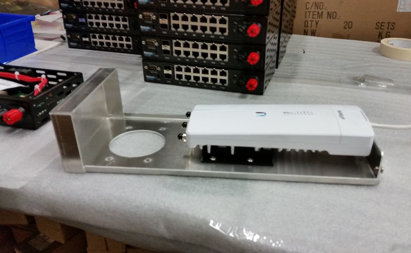

Same here but I am putting mine in the NEW RF Armor Rocket cover designed for the AFX :arf:

The new box will change out easily with existing boxes without needing to take the dish down.
Just open the cover, remove the Rocket, remove 4 nuts, slid off old box, then slide on NEW box.
DONE

sirhc wrote:The new box will change out easily with existing boxes without needing to take the dish down.
DONE
How much and when? My issue as of now is I have to take down the existing dish and replace it with a regular one and then tranfer the RF armor radome to the new dish because of the rocket shields (I now have stacks of them in the office). I have both the older and newer versions and as of now I was going to instead of replacing the dish just get longer SMA cables and mount the AF directly to the tower standoff. These new covers would be an option now as well.
