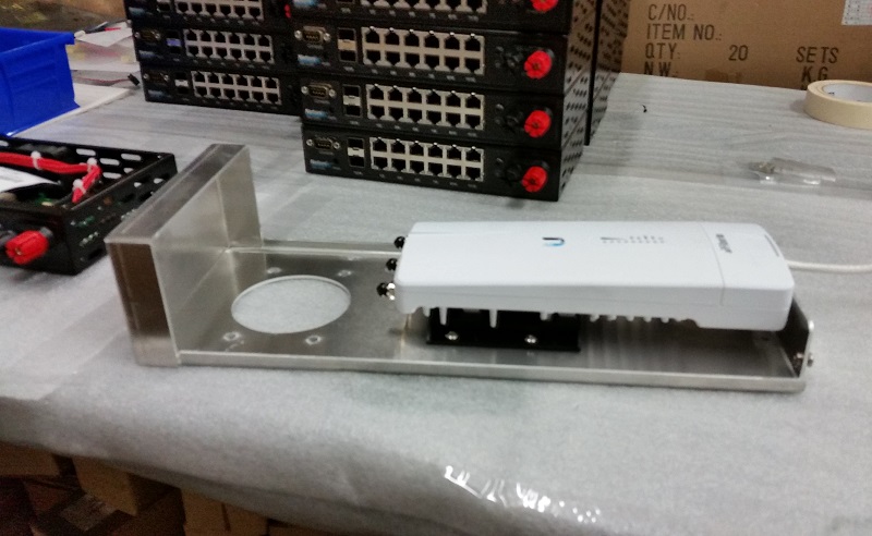

Same here but I am putting mine in the NEW RF Armor Rocket cover designed for the AFX
Re: AF 2.4,3 X thoughts?

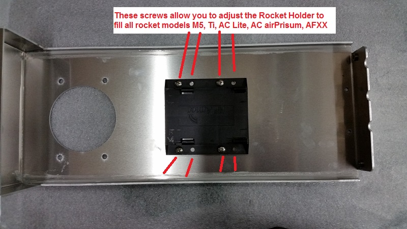

The new box will change out easily with existing boxes without needing to take the dish down.
Just open the cover, remove the Rocket, remove 4 nuts, slid off old box, then slide on NEW box.
DONE
DONE

How much and when? My issue as of now is I have to take down the existing dish and replace it with a regular one and then tranfer the RF armor radome to the new dish because of the rocket shields (I now have stacks of them in the office). I have both the older and newer versions and as of now I was going to instead of replacing the dish just get longer SMA cables and mount the AF directly to the tower standoff. These new covers would be an option now as well.

It will not overheat!
Now if I was putting them up in Death Valley or on a rooftop in Vegas in direct sunlight I would take the time to paint them white otherwise no issues.

I have run my first AF-5X pair covered by RF armor shields for several months now. And it has been summer here. The box is daily in direct sunlight. No problem at all....
