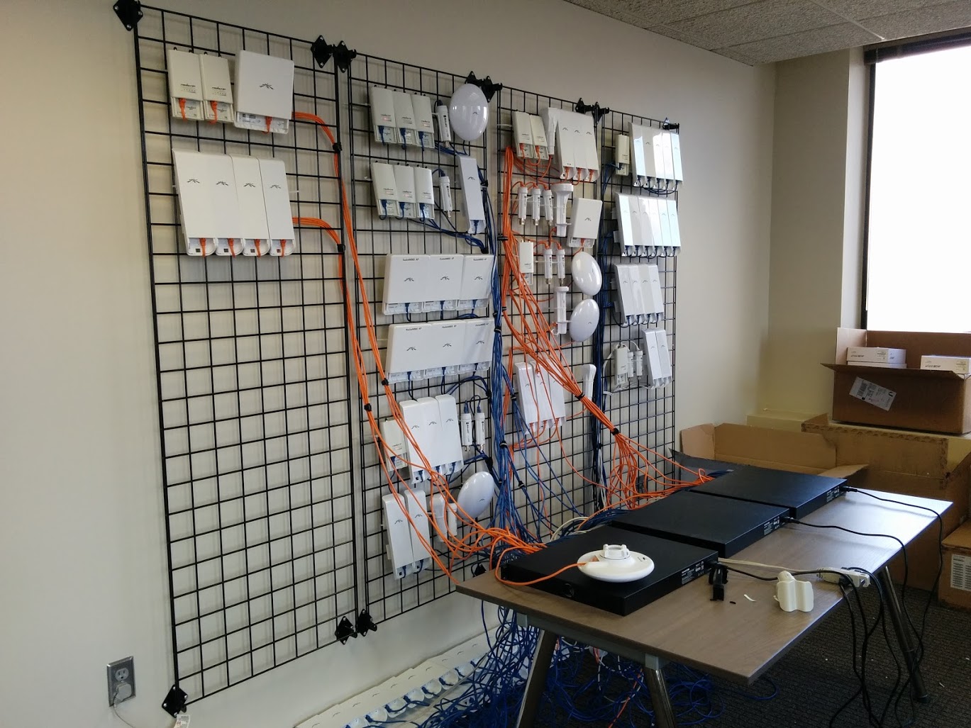

I know RX deafness was an issue back in the days of their modular PCI radios but they claim it to not be an issue with the modern kit. Matt and WHT liked to bring out the wall of RF pic whenever the topic came up.

Yea and those devices are NOT actually doing anything of value. Can you hang 100 devices on the wall and power them up and go to their UI sure but try having them connect and do anything of real value is another story.
Look radios BLEED into the next channel and when radios are close by each other that little tiny BLEED is LOUD.
How can a manufacturer tell you that your over driving your signal turn down the power in the same breath say that a radio sitting right next to it YELLING in its neighbors ears when the neighbor is trying to hear a whisper from 5 miles away? - LUNACY
If your radio hears any signal louder than -40dB not just the one it is listening to that is not good!!!

...and batteries don't have memory anymore either...
That wall looks neat, but how long was that run for? What happens a year in?

lligetfa wrote:I know RX deafness was an issue back in the days of their modular PCI radios but they claim it to not be an issue with the modern kit. Matt and WHT liked to bring out the wall of RF pic whenever the topic came up.
That picture makes we want to break out the tinfoil hat!
