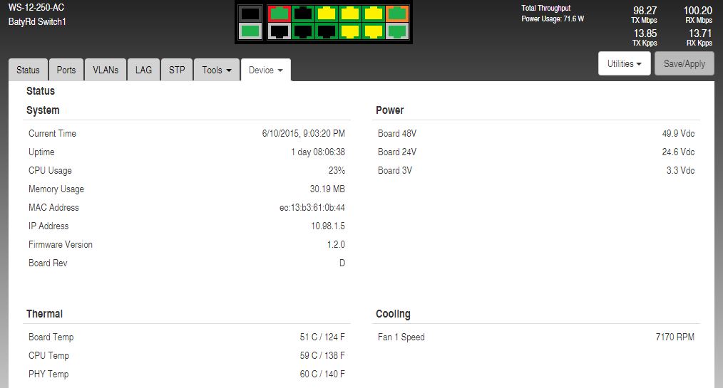

Here is screenshot of one of the modified switches....DC power baby! Port 1 is powering mimosa, port 11 radwin and the rest are ubiquiti rockets.
- Capture.JPG (54.22 KiB) Viewed 21425 times
