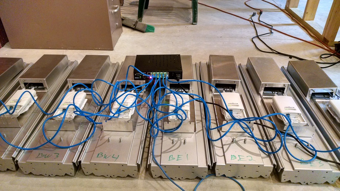

getting ready to put 8 additional AC45 sectors with shields on 600 ft tower, and replacing switches with modified Netonix switches to make them DC :)

Channel plan is to find least noisy channel to operate on in any given direction :) I run 10 mhz channels so it's not real hard to avoid self interference, especially with rfarmor shielding. This will be in addition to the 10 sectors and 4 backhauls that are already up there. There will be two 14 port netonix switches converted to DC and pretty much all the ports will be used.

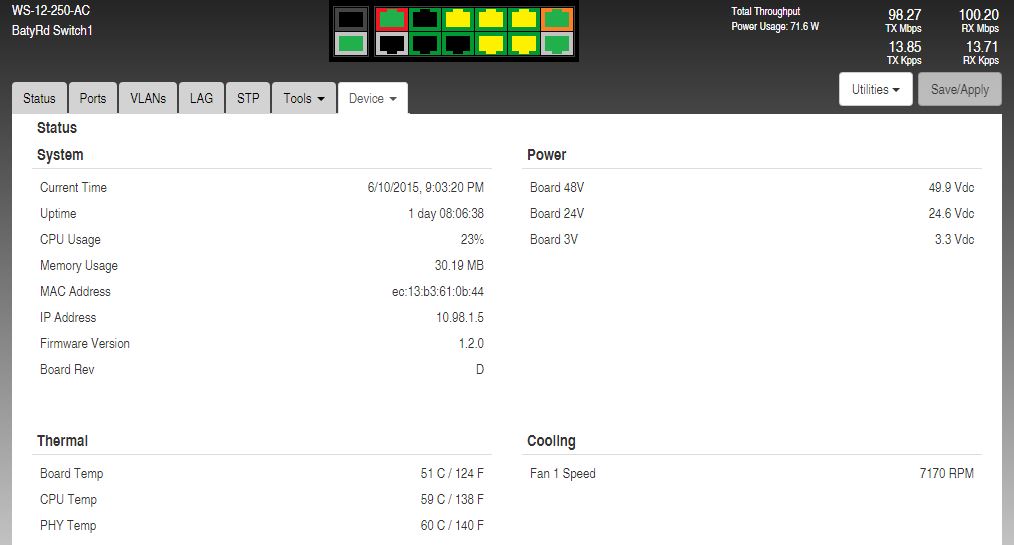

Here is screenshot of one of the modified switches....DC power baby! Port 1 is powering mimosa, port 11 radwin and the rest are ubiquiti rockets.

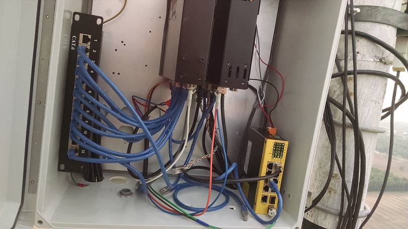

I went from this...
To this....I know, still needs some work :willy:
