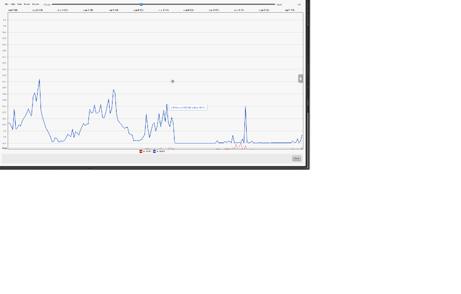

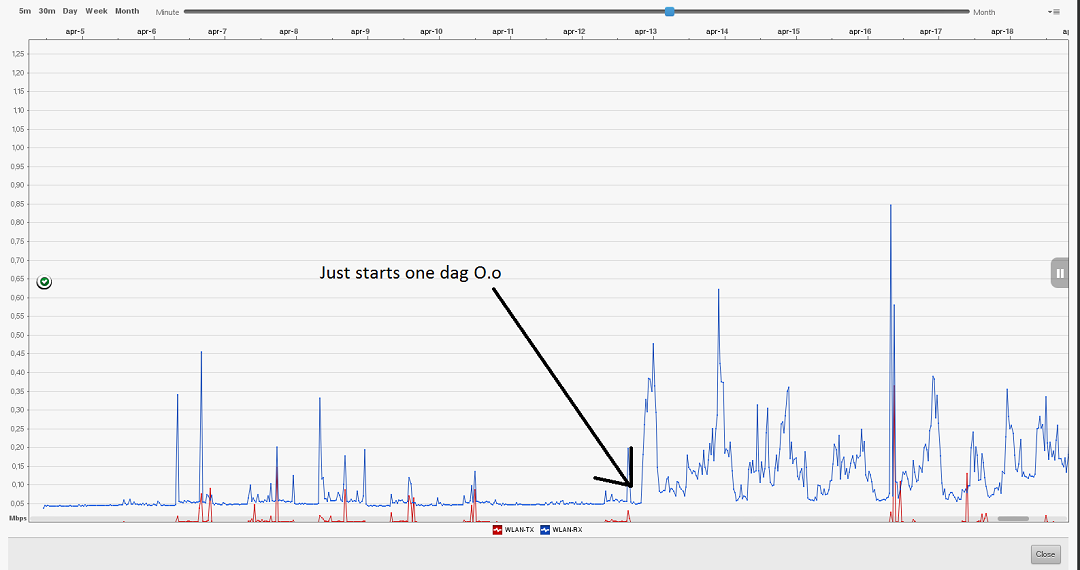

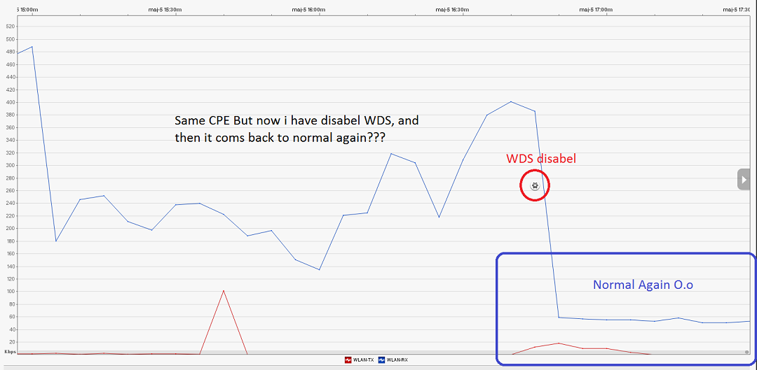

Does anyone know why I'm starting to get some devices (CPE's) standing and use data without the user is on the unit.
And the when I turn WDS off from the CPE side and leave it enabled on the AP side, it falls to normal again. :headb:

Just think that it is crazy :crazy: that a device that is not being used can use up to 1.5 Mbps on doing nothing, and when I turn off WDS on the CPE side it falls to 30-50 kbit.
what would you do :?: , just turn WDS off from the CPE side or just leave it and let it use data.

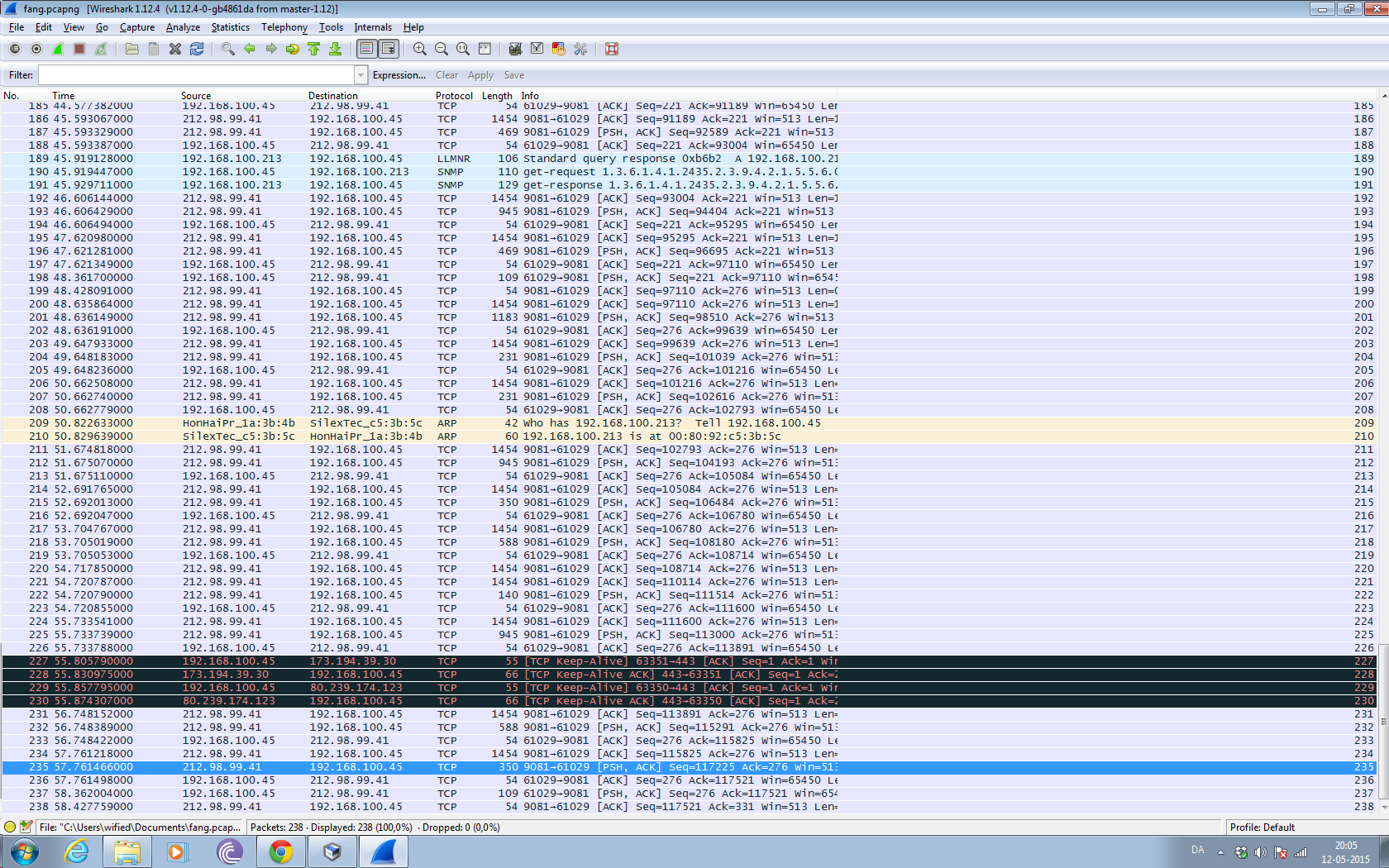

I would keep WDS on and figure out the source of that traffic. You can plug into the radio with a laptop and capture packets with wireshark. Then you can see whats going on.

ok I'll try to take the data out whit wireshark
ty :thumbsup: .
I know it is not use, i have to talk to the customer and can also see that the data output has changed, after i turn off WDS from the customer devices.
I don't hope it is a virus :Cry2:

have tried to capture some data from one of the devices, but do not know if I'm doing it right or what to look for Pirate7
