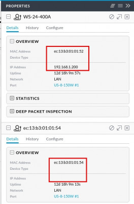

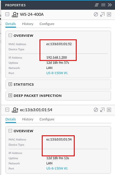

It is entirely possible that MAC does not have an IP. Do you not keep records of all your equipment MAC addresses?TowerTech wrote:I have a Netonix Switch that we have lost IP for When I look it up in the mac table lookup this is what we get. It's a mid tower switch and would require a climb.
"ec-13-b2-91-38-ef 1 1 Netonix Unknown"
It shows MAC but no IP.
What is your advise to get the IP Sirhc?
Probably it is used only on the broadcast domain and so doesn't need an IP.
