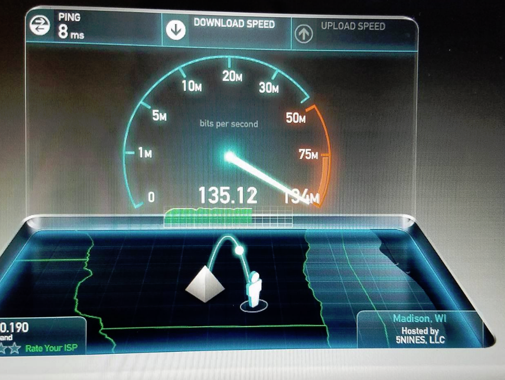

I'm in the same boat as you.. Just about out of AC radios, they work well for us. Did an install today, 135Mbps down, 8ms ping, on speedtest.net. R5AC Prism 20mhz channel, with a 400 AC CPE. This is over 3 AF5X links back to our fiber even.
