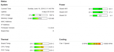

From a different location, here's a screenshot of the switch status page:
Status Page

Here i am running at 107F outside right now
But the new netonix 8 port dc is running 9060rpm @
61c Board
81c CPU
78c PHY
74c PSU
I was hoping to do a little better than 61c and unfortunately i don't have a device that will give me ambient air temps. I assume each model will be a bit different but i'm blowing a lot of air through that box. 30 Watt blower, sun shade, high efficiency psu's etc.
