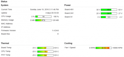

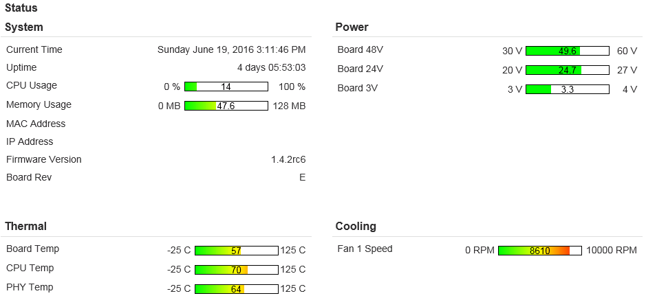

From a different location, here's a screenshot of the switch status page:
Status Page
To add insult to injury, at one point Accuweather said it was 119 but the 'real feel' was 121. Yeah, that's what we get instead of wind chill. :headb:

Here i am running at 107F outside right now
But the new netonix 8 port dc is running 9060rpm @
61c Board
81c CPU
78c PHY
74c PSU
I was hoping to do a little better than 61c and unfortunately i don't have a device that will give me ambient air temps. I assume each model will be a bit different but i'm blowing a lot of air through that box. 30 Watt blower, sun shade, high efficiency psu's etc.
Re: 120F and Hangin In There
Tue Jul 26, 2016 7:33 pm
Well just imagine how hot a fanless switch would be.
That board temp is plenty fine.
Considering the CPU and PHY are rated to 125C and the rest of the board to around 80C.
The fan is there to prolong the life of the switch as you would be surprised what air flow even hot air flow does to prolong the life of electronics.
