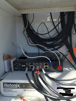

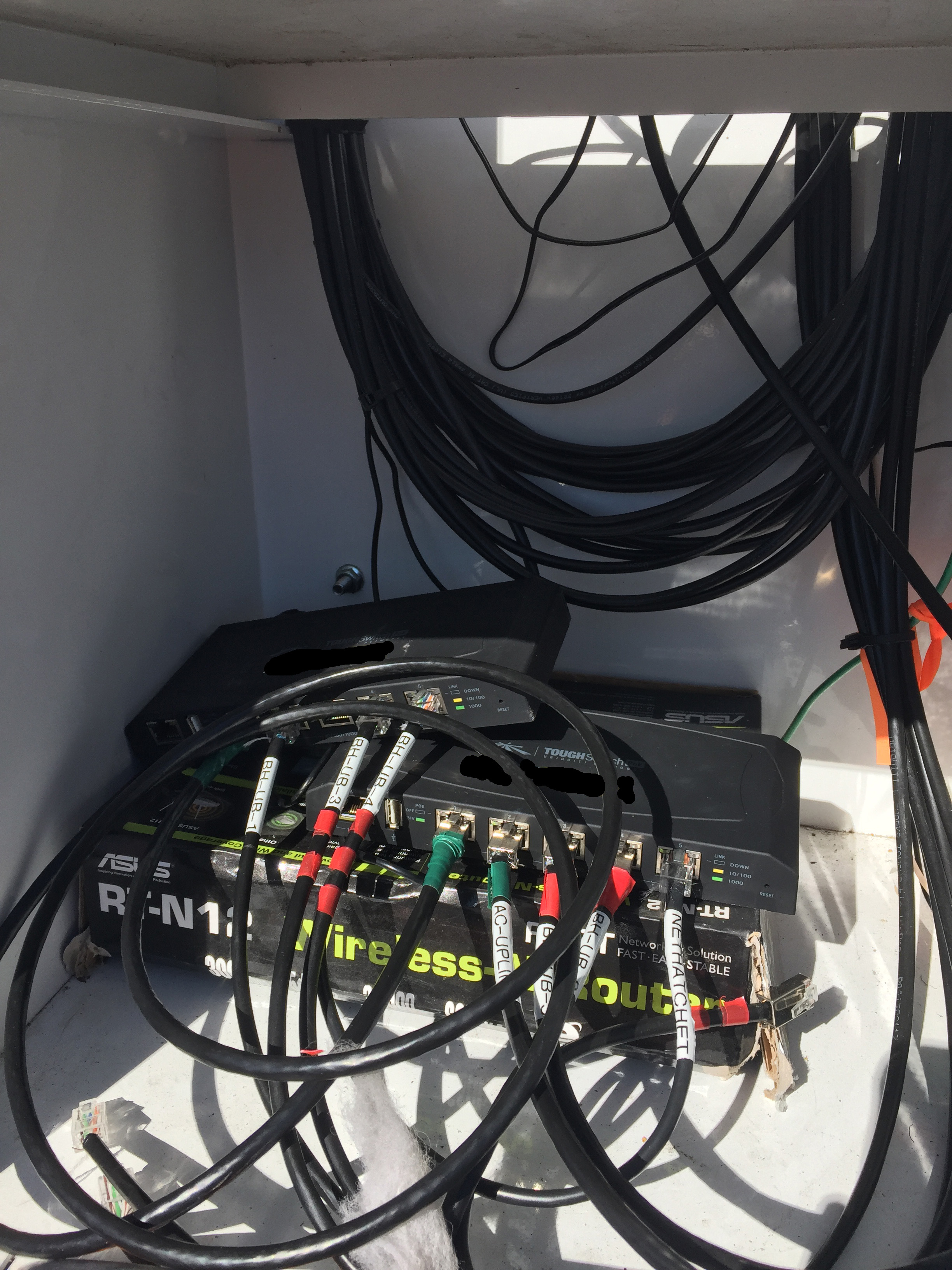

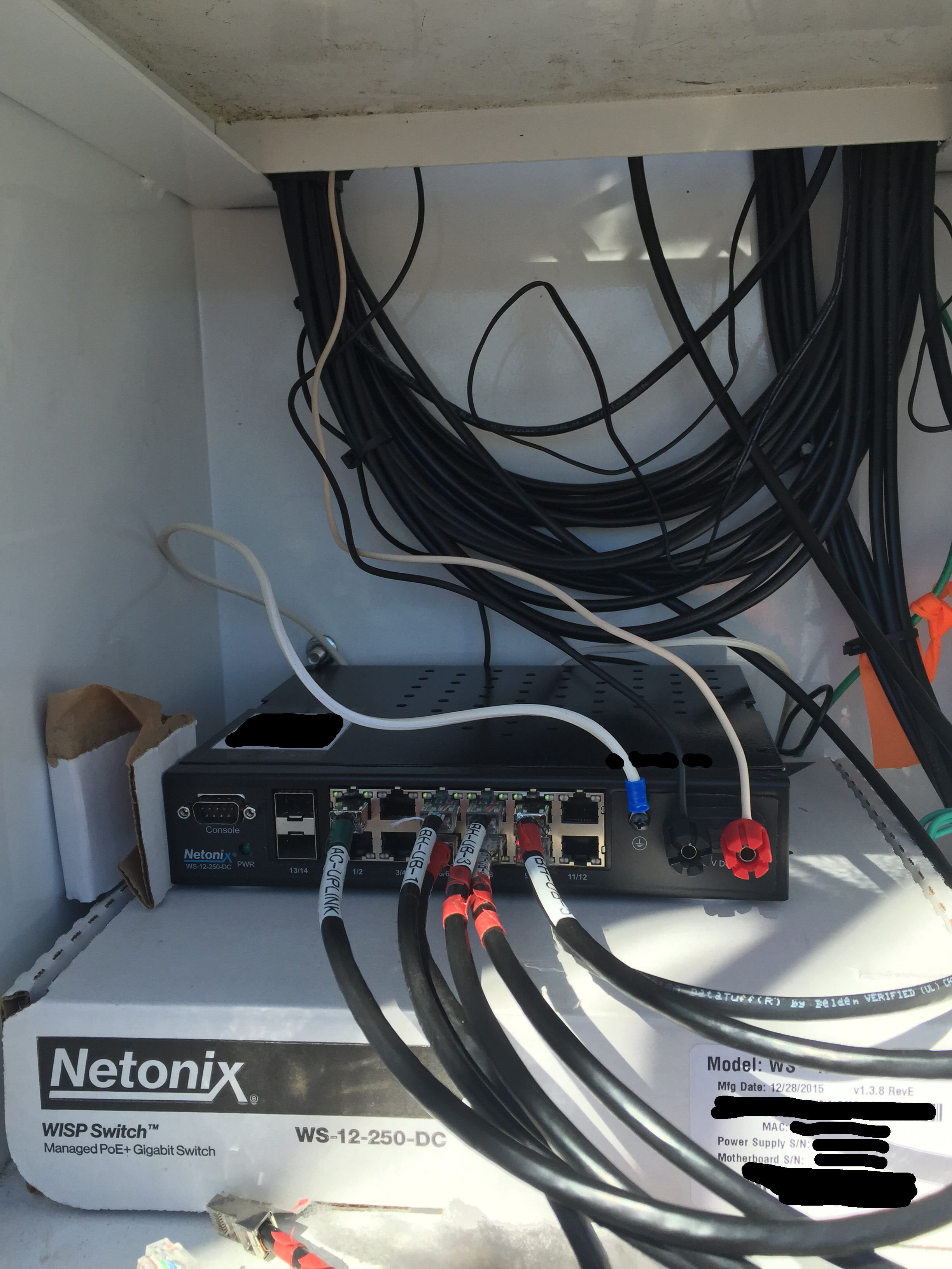

Re: 5 Port Ubiquiti TS to Netonix Switch
I noticed I never posted the screens of the WS-12-250-DC unit we replaced on the hill. We have not done the cable management at this location yet so it does look like crap. I know my ground wire probably shouldn't be white, but it was the only color I had on me at the time...
