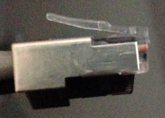

This is EZ RJ45, the tabs are flush with the clip.
This is the RF Armor

Sorry about the pic size and quality. I couldn't find a way to set the size on imgur or the forum tool. I think you can see the difference at least.

I managed to crop them a bit. I think you can see what I'm talking about though. The clip is thicker than the locking tabs on the RF Armor connector. This is enough of a difference on some jacks to make it very easy for the clip to disengage.
The solution would be to make the lock tabs the same thickness as the clip as in the first picture of the EZ RJ45.

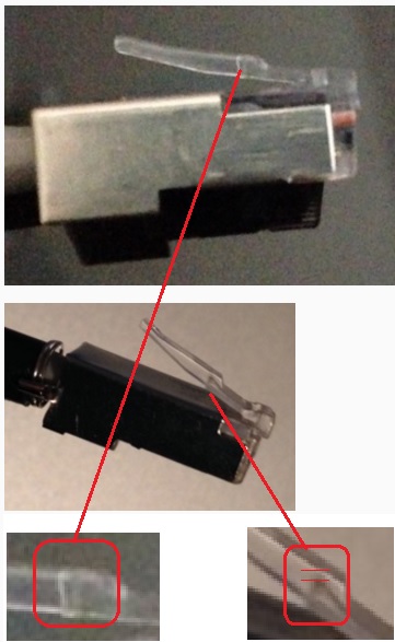

I resized and cropped them for you with MS Paint.
Not sure what you mean by Tab. Maybe edit picture with paint and put in some red arrows.

Kevo wrote:The solution would be to make the lock tabs the same thickness as the clip as in the first picture of the EZ RJ45.
Yes, I see what you mean. The top of the release tab stands proud of the lock tab keeping the lock tab from full engagement.
As I said, the way I work around that is to add a bend to the wide section of the lock tab by sticking a small screwdriver shaft under it and bending down. Sometimes I use a small allen key instead.

Is this what you mean?

Yes, that little gap, and the associated hump on the clip work together to make these pop out very easily on some ports.
