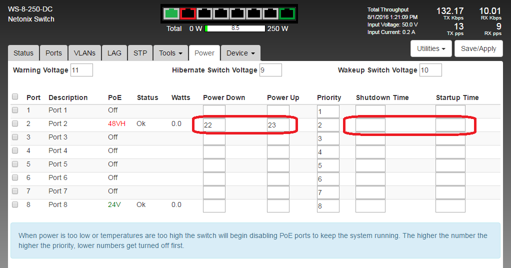

rebelwireless wrote:Would be nice to be able to trigger this by monitoring battery capacity and sending an API call to the switch.
The SMART DC switches allow ports to be shut down based on time or input voltage level?

My only suggestion for the shutdown options, would be a logical way of powering off links after bandwidth falls below or above. The below is easy as you'll be monitoring the same link as you're dropping. It would be more difficult to activate an already shutdown link when the backup is over x amount.
Currently I've programed this feature into some dude scripts and CLI.
