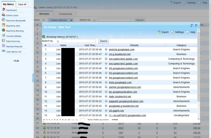

Re: UBNT (WDS) Need help - POSSIBLE TOOL TO HELP
I use this to see what's going on. It runs on a windows machine connected to a mirror port on a netonix switch. It runs all the time. Gives a running total of bandwidth for each customer. It can also block.
- Attachments
- customers.jpg (77.85 KiB) Viewed 16573 times
