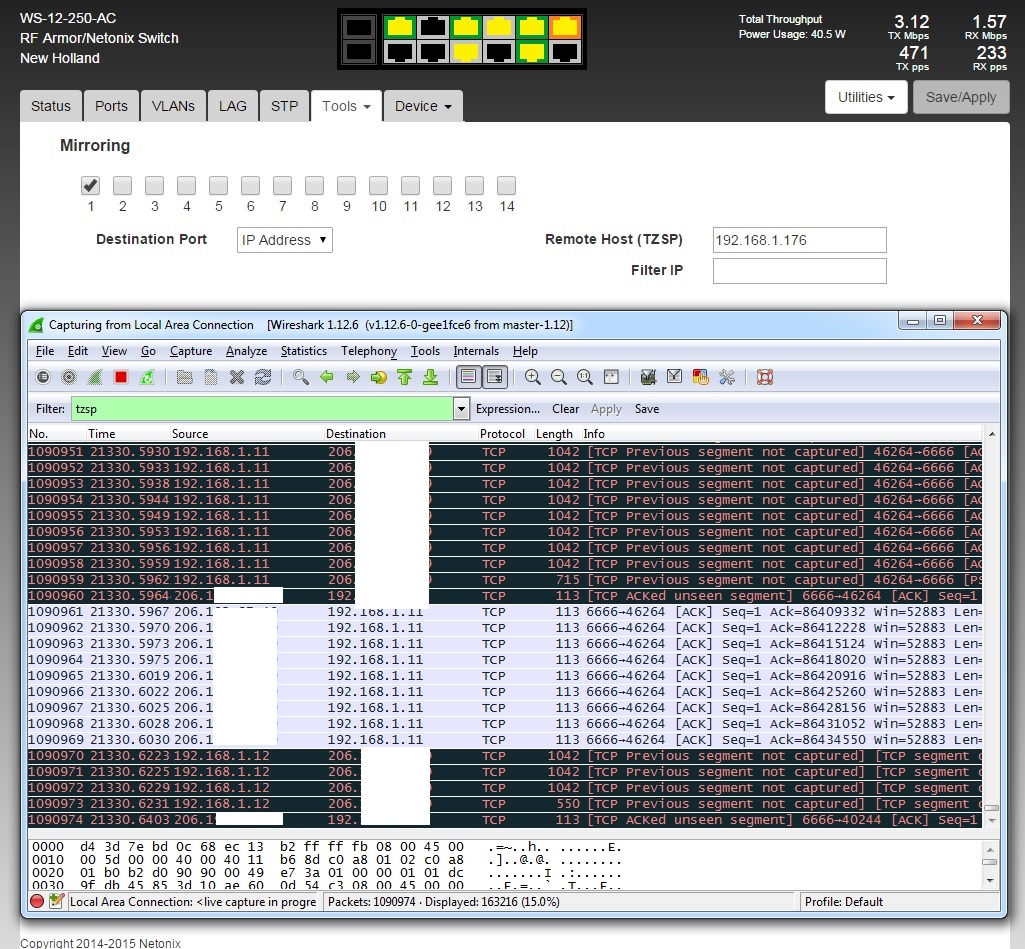

Re: UBNT (WDS) Need help - POSSIBLE TOOL TO HELP
Wed Jun 24, 2015 5:49 pm
OK I am putting up a new v1.3.0rc9 as rc8 would cause the switch to lockup when mirroring to an IP.
Also v1.3.0rc8 would falsely disable POE ports on a reboot.
In a few minutes I will post about using Mirror to an IP and WireShark but do NOT attempt it with any version less than v1.3.0rc9
Wed Jun 24, 2015 5:58 pm
rebelwireless wrote:Chris, I'm not familiar with the switch capabilities enough to know this. If you have a couple ports in a LAG group, can you mirror the LAG? or are you stuck with just a single port? Port mirroring I think limits you to single port configurations, or maybe mirroring each LAG member to a separate mirror port.
Using nTOPng, you can bridge two ethernet interfaces (say two that were mirrored from the LAG group) and monitor the bridge. Then you don't need nProbe and can do it for free.
OK, you can mirror ports in a LAG but a LAG is only a cluster of ports so if you have a LAG and you want to insure you get all streams you need to select all the ports in a LAG group and then MIRROR them to a single port and capture with WireShark or MIRROR them to an IP and capture it with WireShark.
If mirroring to an IP and you only want WireShark to display only packets MIRRORED from the switch you just need to have a Display Filter "tzsp" (It is case sensitive so must me lowercase).
DO NO TRYING USING MIRROR TO IP UNLESS YOU ARE USING v1.3.0rc9 OR NEWER
previous versions "will" lock up your switch.
Sun Jun 28, 2015 3:59 pm
TZSP
https://en.wikipedia.org/wiki/TZSP
However this is still in BETA and it will only mirror 6 Mbps.
So if you MIRROR a remote port to you laptop running wireshark you will only get 6+/- Mbps of the actual traffic, I wm working with Eric to increase this limitation but we want to crawl before we run.
