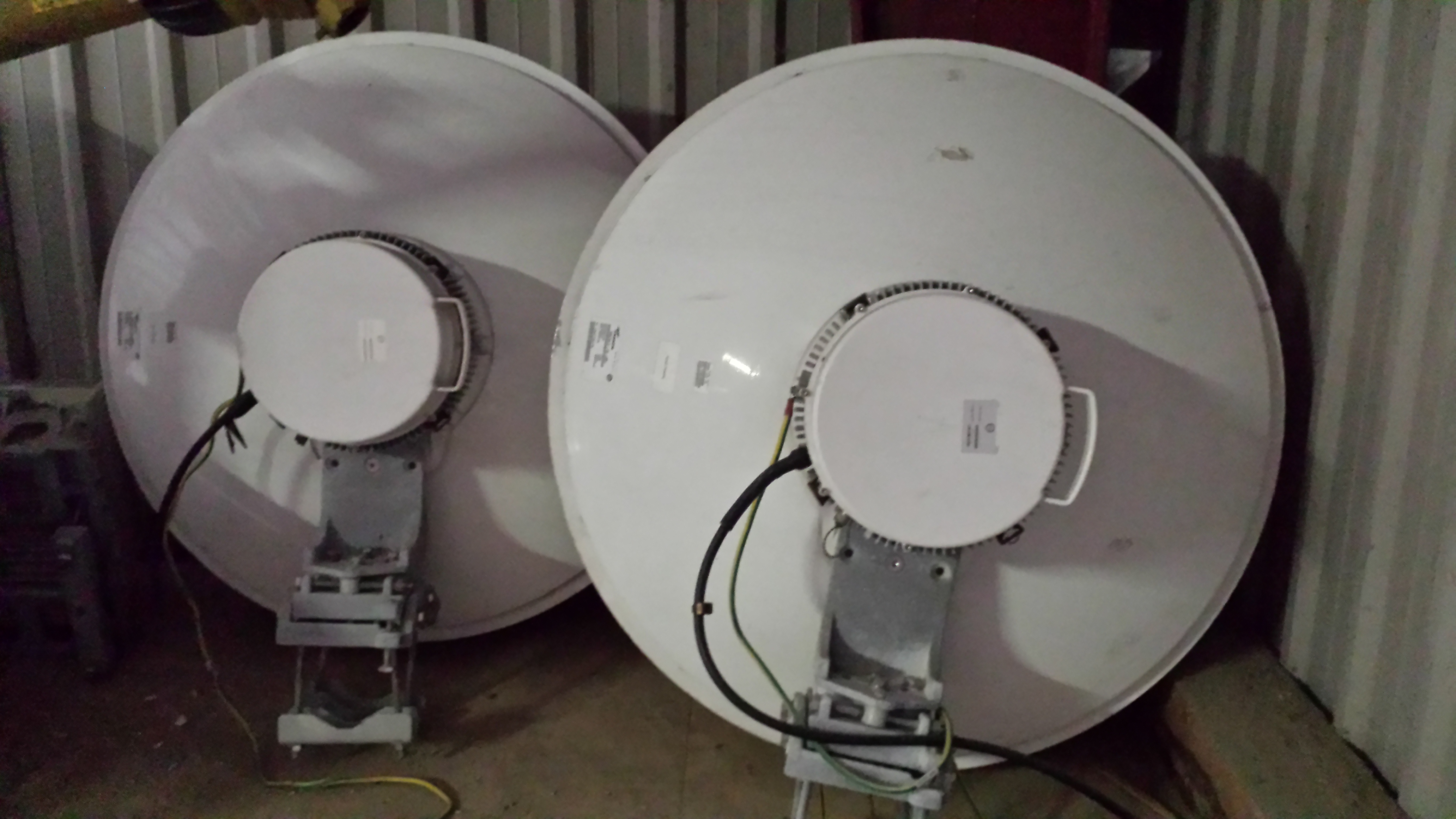

Actually I have some Ceragon stuff laying around if anyone is interested ?
2013-07-27 17.31.38.jpg (1.79 MiB) Viewed 36520 times
With IDU with STM modules....

Sat Sep 19, 2015 6:25 am
Is that from the generation that required a 56 MHz channel for STM / 155 Mbps? if yes, it won't be easy to get an operating license these days (at least in Germany) due to inefficient spectrum use.
