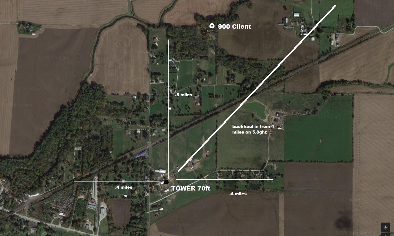

OK equipment is going up this week. Tell me if i'm ok?
Tower is @ 75ft to get clear LOS for backhaul approx 4 miles away receive on 5.8
I'm on a tight budget (startup)
there are max of 40 houses in this area. 8 have committed to signing up. I would guess 12-15 total might eventually signup. I don't see more that 20 total
I would like to have clients on 5.8 if possible but i will mount 2.4 as secondary
Topography:. from tower to top of picture it rises 11ft. from tower to right it's flat with a 10ft dip in the middle. from tower to the left it's flat. from tower to the bottom it drops 15ft

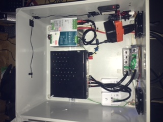

my initial equipment setup is as follows:
Netonix ws-8-25-DC plus 2 batteries to 24v DC power all equipment listed
Meanwell sdr-240-24 plus dr-ups40 for converting 120v to 24v and battery backup
Mikrotik RB400 or Edgerouter x to route the packets (not decided yet, i'm learning edgerouter and have MT everywhere else)
PBE-M5-400-ISO for backhaul
Netonix WS-mini to power the AP radios
AMO-5G13 (maybe should be using the AMO-5G10 instead because of the better downtilt?)
AMO-2G10 (for those in the light tree area that has schetchy 5.8 coverage
LOCO 900 for one client buried in the woods at the top
Picostation M2HP converted to unifi mounted low to give horses internet access :hurray:
I do have 3 of the AM-5G19-120 plus rfarmour shild kits but i think thats overkill for the amount of clients vs cost of deployment. I was going to use that upgrading a heavy used water tower to sectorize it from 2.4
Recomended mounting height for radios?
am i on the right path?
Lastly i'm asking for help on setting up the Switch. Everything i've worked on has been a basic POE to power radio and Ethernet to router thats setup DHCP client and same for others setup as DHCP server for radios. I know its possible but i'm not getting my head rapped around the concept for tagging and setting up the Netonix to power all radios and router.
Example
Port 1 to power the BH radio
Port 2 to power the ws mini
Port 3 to power the router (edgerouter X)
port 4 to power "backup" router (rb400)
another port for DHCP server output? this is where i get lost. :headb: help please!

Not sure why you did not just use the ws-8 to power all radios, trying to figure out why you need the ws-6 here?
Answer: Tower is located in a horse lot and i didn't want the horses messing with the cables or enclosure and deal with getting 120V to the tower (not many places to get power in a horse stall) so i moved the enclosure inside the barn. With that move i now have a cable run from the top of the tower to enclosure of around 225-250ft. It was easier to run 2 cable runs plus ground for that distance and then power all the AP radios off ws-6 from 1 run and the BH off ws-8 from the other.
Was that incorrect?
Box of wire vs ws-6 is about the same $ so i decided for the easier route.
Was that incorrect?
Why not use one ethernet run for data, and the other as a dedicated power cable, and run everything off one switch? Or run a dedicated DC power line. You have the right WS8 so some voltage drop isn't a big deal.
i have 5 UBNT 24v devices that need power and ws6 only powers 4.
Dedicated DC power leaves me with ws8 switch mounted on the tower. I considered that but i was not felling good about the ws8 mounted in a NON vented enclosure where temps easily get above 115F in the summer and regularly fall below 0F in the winter (operating temps of ws8 are -13 to 131° F) and vented enclosure on a tower up top? the additional cost of that enclosure would negate the $cost of the ws6.
I know the ws6 has the same temp range but there is no fan and assuming it wont get as hot and fits in a smaller enclosure.
